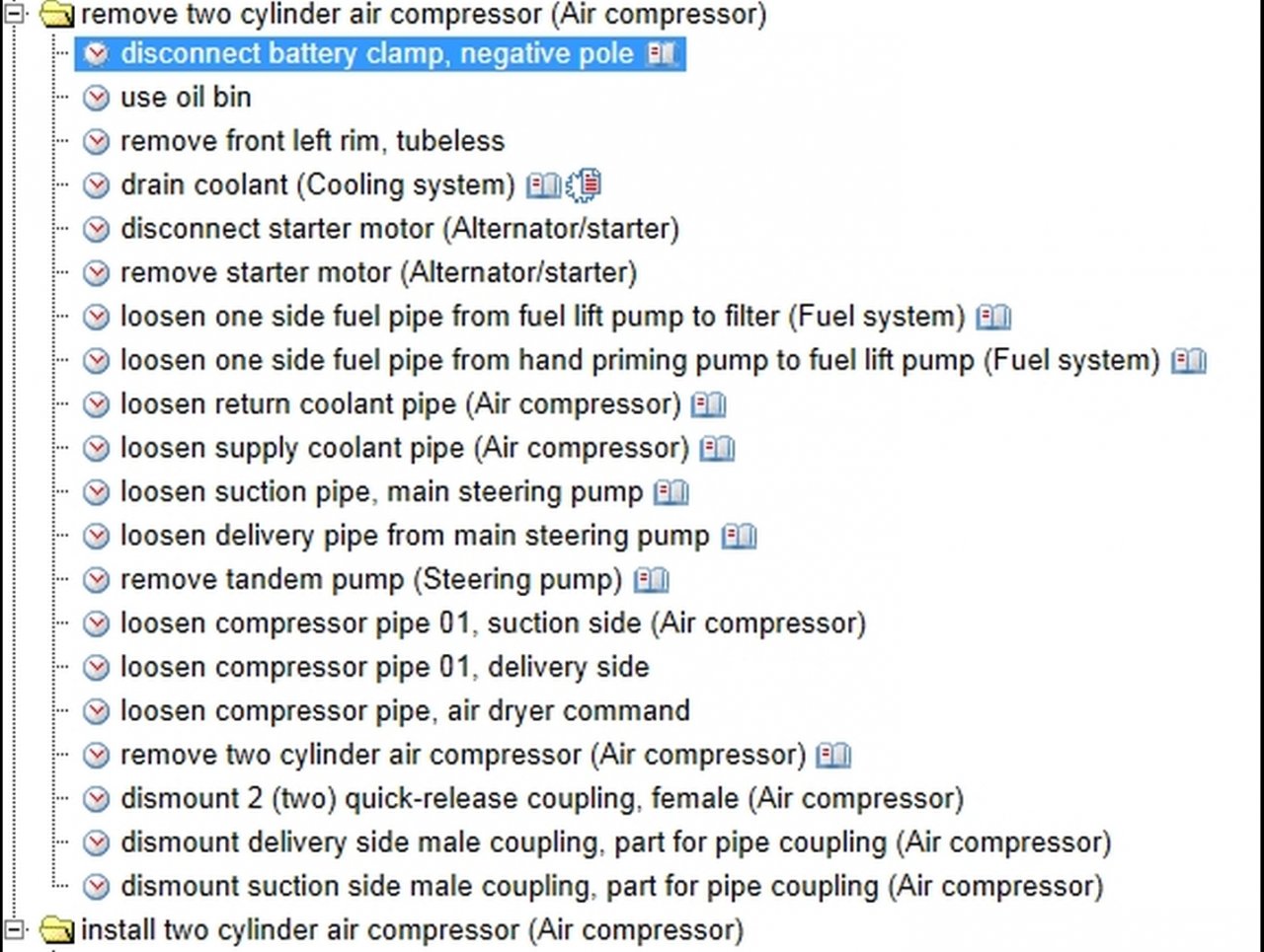

    Peterbilt is NOT an option for ANY truck owner in Phoenix. We all just know, its something everyone in Phoenix laughs about... You just don't go to Rush Truck Center in Phoenix. They're criminals. MHC Kenworth are not much better. They may not be criminal like Rush but they are parts slingers. They plug in, send an e-mail to their Rep, throw whatever parts he say at it and hope for the best.
    If you happen to own a Paccar (as I did till I built a 6NZ) Kenworth has no problem just casually mentioning "you need a new engine" ($40,000)... Or "you need a fuel pump, that'll be $4,000"...Neither of those places knows how to deal with a truck or truck owner that has no warranty. You say they are willing to help with costs???? No, not in Phoenix. Sure, they'll take half the labor off while saying "sorry, we can't fix your truck, but we'll take half out labor cost off the bill".
    You don't know why I keep saying the engine needs to be removed? Because IT DOES! Im not sure about any other make or model but a 2013 389 with an MX13 requires an engine removal to R&R those parts.

    I'm not sure why I didn't respond to this way back when - probably because I didn't want to look up the actual steps to show you.
    In any case - here's the actual information in a MX13-13 389. The only repair that you mentioned which actually requires engine removal is the camshaft. Air compressor, fuel pump, etc - no removal necessary, again, I'm not sure why you keep thinking it is.
    Side note in the air compressor - the repairs generally take about 4 hours(ish), so if you're removing the entire engine and replacing the air compressor in 4 hours I'd be really impressed.
    Here's the steps to remove the air compressor and fuel pump. I didn't provide the cam because they're much longer and as stated - it does include removal of the engine.
