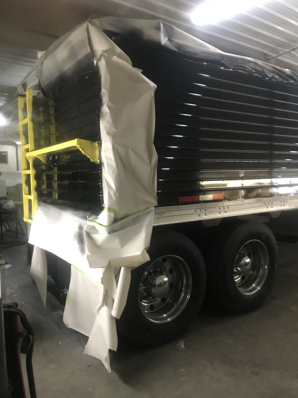

    96BF2C8C-A323-420E-8573-E007CA23F777.jpeg Got the back painted and top hats on.

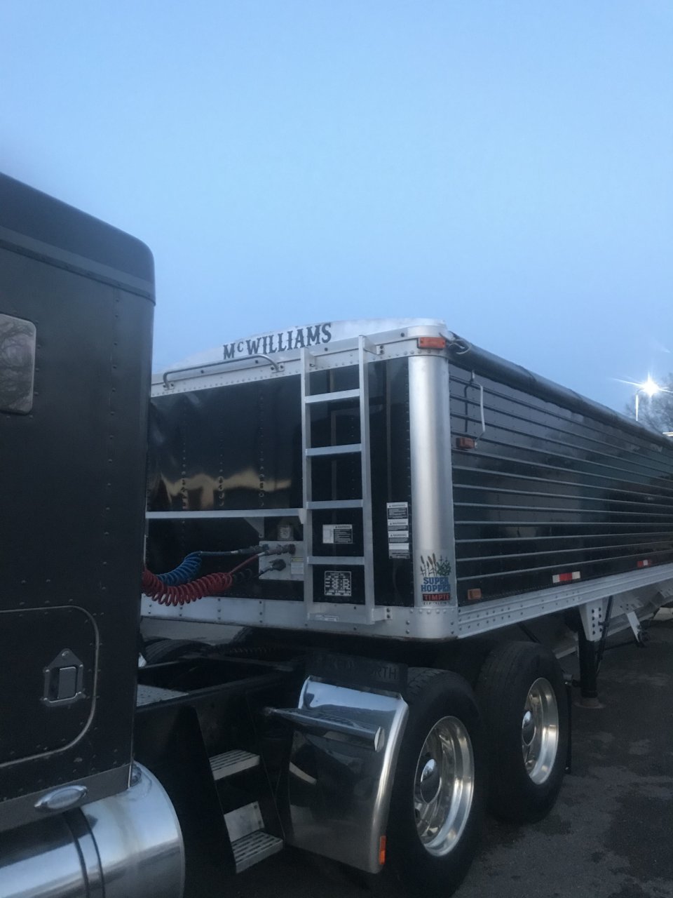

    78FBA09D-8219-476F-8A17-6025A6DC6BF0.jpeg 47FB6352-B0B8-47C5-A97A-E818824BD07C.jpeg 3F3E7E4A-9C7A-4F4E-8B99-477EA874CFFE.jpeg Well I guess it’s done.
