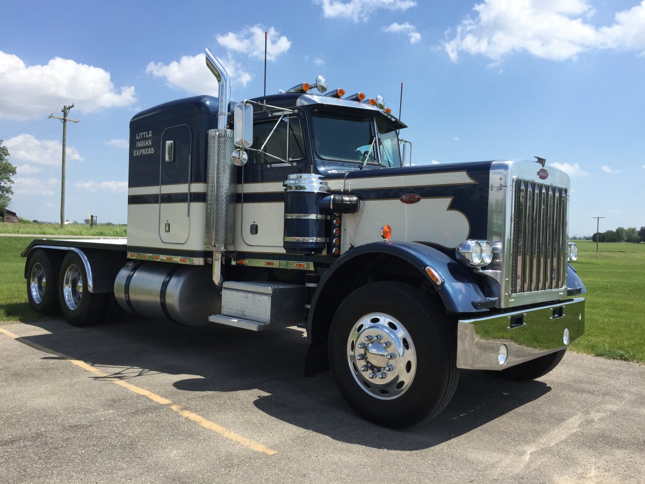

    My ride. The blue is base clear and cream is urethane. I am also into old cars and urethane will out shine a base clear. 426 (2).JPG

    ahhhh there it is Been a while since I've seen a pic of her Gary.

    Nothing like a Seminole scheme on a 359.

    That's all class. Old school all the way, I too love the Seminole
