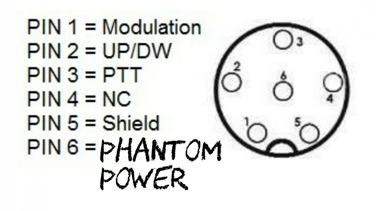

    Well the 68ltd and the 29ltd are the same. I don’t know about the 980 & 880 since the have a 6 pin jack. I haven’t been able to find any info on the mics pinout for those radios.

    This might help.
    STOCK MIC PINOUTS;
    PIN COLOR FUNCTION
    1: Yellow Audio HOT
    2: BLACK RX switching
    3: RED TX switching
    4: N/C
    5: SHIELD
    6: 7.8VDC (as-found on this pig-rig) phantom power for power mic*
    * Not used on stock mic.
    Night Stalker10 Thanks this.

    Okay very good, thanks. Well it’s definitely different from the usual uniden/cobra pin out. I figured one pin had to be for phantom power to feed the electret element, I just wasn’t sure which one. Interesting they have one pin not being used.

    As I posted a while back the Magnum Omegaforce S45 stock mic works on the 980 so pin 6 must be hot probably similar to the President Grant II.
