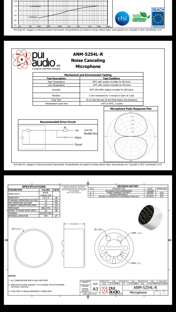

    Another stupid question, the one I had uses a AAA but schematic has power listed at 12 volts.
    Which is it?
    rabbiporkchop Thanks this.
  3. rabbiporkchop
    9,678
    6,546
    Feb 9, 2012
    Wapwallopen, Pa
    Of course not. I suspect it might be this one.

    Uses a single 1.5v battery.

    I find it interesting that they consider the mic element itself noise canceling. Looking at the specs, it would be a nice element to use.

    Now that I think about it, since the sl41 mic uses an electret element, you won’t need to run the mic gain very high. Wouldnt think it would cause a squeal in the radio though.
