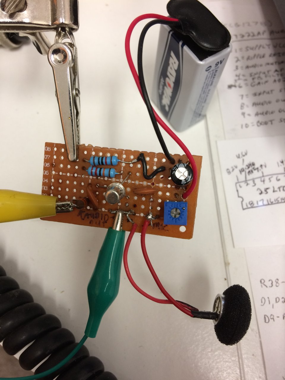

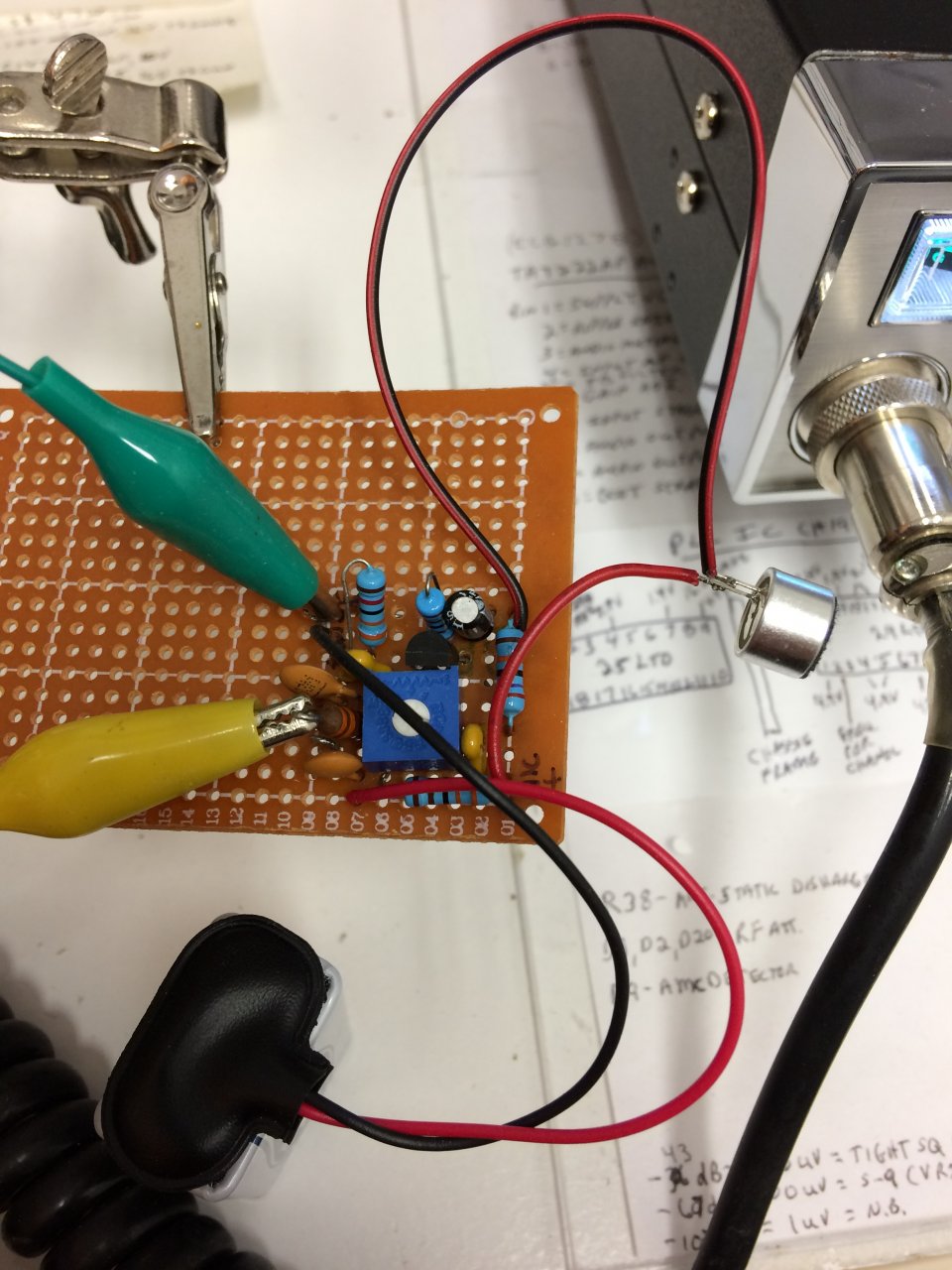

    5A862828-5A31-49BB-9B59-DD5AEFE310DE.jpeg E77F6C6B-825E-4F96-BBE7-0CE066970054.jpeg 0B7FBC28-13F9-4629-B482-A4CCC263829A.jpeg
    A few months ago I was experimenting with mic designs using the electret element. I chose 1k ohm element from digi-key, p/n 102-1722-ND. The first pic is basically an astatic d104m6b modified using the electret element. It still has a nice mellow sound to it, kind of like fidelity.
    The second picture is just a basic board using a 2n2222A transistor. Both mics have a nice clear sound thanks to the electret element. I had a pair of old ear phone foam covers that i used on the mic elements to act as a wind screen.
