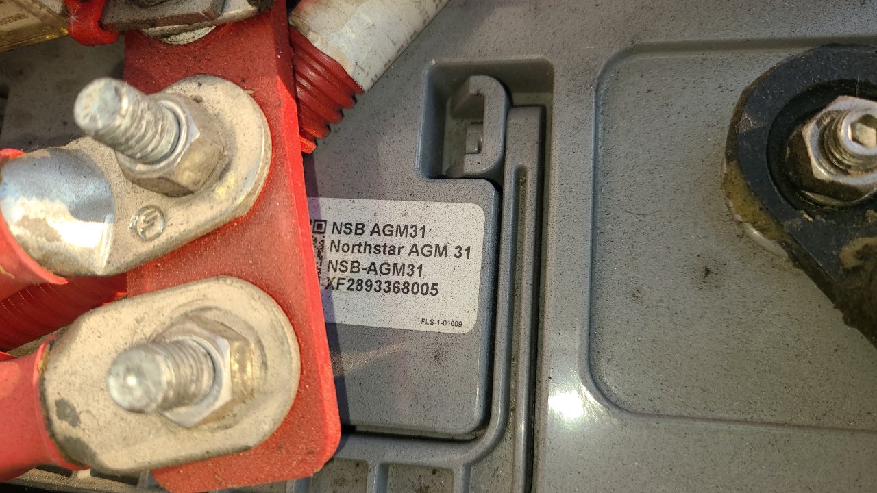

    i am in Indy now. Outside is 89f. parksmart is working but not enough strong to keep inside cold.
    I opened battery bays today and i was shocked. there are 8 Oddisey agm batteries. ####! thats $450 each of them. when they will get bad i will not buy them. $4000 for batteries ??
    Honestly this system is expesive ####! Tripac+ Espar is much better ...unless you live in MN or WI or somewhere north

  10. armo
    armo Light Load Member
    274
    290
    Jun 16, 2022
    look at thr batteries... #### it. expensive to replace them
    20220705_073819.jpg 20220705_073916.jpg 20220705_073832.jpg 20220705_073827.jpg

    I got news for you: Odyssey and Northstar are superior to every other AGM battery on the market and worth the price of admission. Batteries Plus X2Power brand is a relabeled Northstar, and comes with a 4 year free replacement warranty. They will discount some if you set up a business account with them, or use one of the many discount codes they offer.
    I've bought two sets over recent years and they are the only batteries I've ever run in a truck that lasted longer than 2.5 years. I put the last set in my '22 Mack last month. They were in a '07 387 for 2 years before I traded it, then sat on my garage floor almost another 2 years before I got around to using them. Right now they have 25% more capacity than the barely year old Mack AGM's that came out, and run good as new. I ran another set in the KW T600 I no longer have. Those had been in it, untouched, for almost 4 years and still spinning that C15 like the first day I installed them. I let those go with the truck, as it had a tight, heat prone battery box and I felt I'd gotten most of the life out of them.
