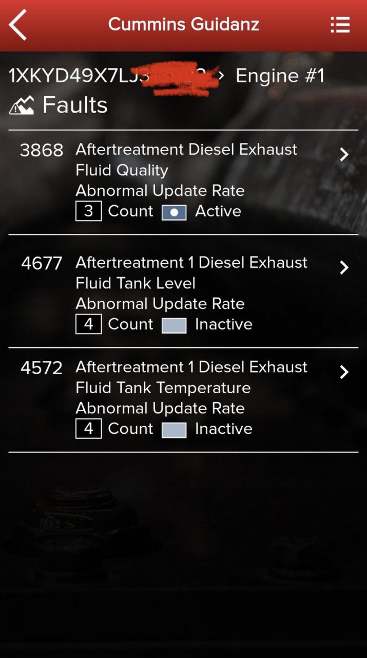

    My turn. Check engine light came on yesterday, after delivering today, ran the truck over to cummins so they could atleast plug it in... The fault codes that came up are pictured below. Cummins "thinks" it's my def level sensor and refers me to peterbilt...
    Go to peterbilt and of course they can't even look at it until Monday... Problems/break downs always seem to happen on long holiday weekends for me...
    Peterbilt did say, if it's the def level sensor and it gets ordered Monday I should have it by Thursday at the latest...

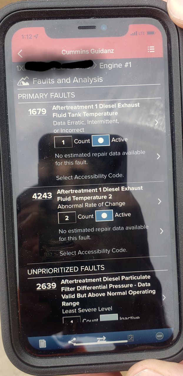

    Ive had two go out in the last couple months and it showed different codes then that. In fact I hadn’t saw that temperature one before. That’s definitely different.
    What city are you near?
    Normally looks like this:
    JonJon78 Thanks this.

    Well dropped truck off to Peterbilt at 0800 this morning. They call at around Noon with updates.
    The DEF level sensor is bad/needs replaced. The new part was ordered should arrive in 2-3 days...
    The SCR/DPF wiring harness is bad/needs replaced. They have it in stock...
