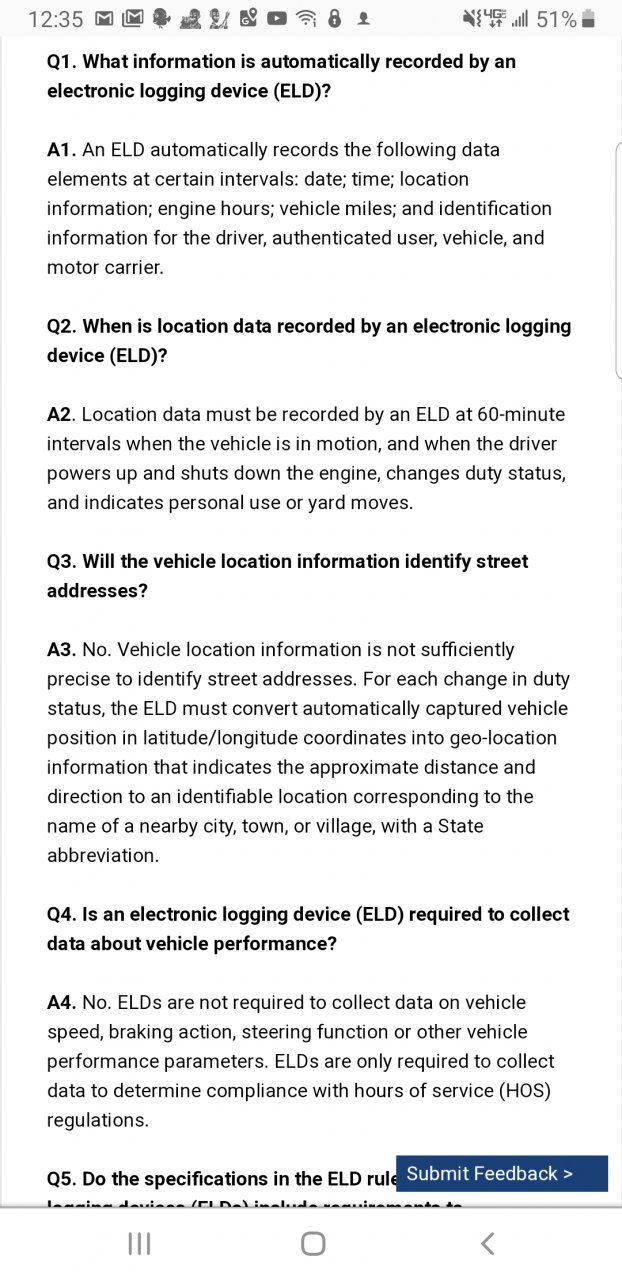

    That is not correct. They are required to be imprecise. Screenshot_20190321-123514_Chrome.jpg

    The ELD does only show Geo-location data yes. He said satellite which is why I specified GPS. A commercial GPS has a resolution of 1 meter. (Looks like I mixed foot/meter)
    An ELD has the same resolution, but it only records two decimal places of resolution, not the full 4 decimals it knows about.
    That said it's still not 1-2 miles. It's 1.1 km at the equator. At the 38th parallel (runs about 1/2 way through Kansas) it's right at 0.8 km, which is 0.498 miles (I.e the 1/2 mile he claimed)
    But all that is irrelevant anyway. The ELD is not allowed to get movement data from the GPS. It's only allowed from the ECM. It knows about the move and there will be a report of "Miles without hours" or whatever that company calls it to shows the movement.
    Here is a primer about resolution if you want...
    Geographic Coordinates In Decimal Degrees - Precision & Accuracy
    Decimal degrees - Wikipedia
    And the text from 395 that specified 2 decimal places.
    7.31. Latitude
    Description: An angular distance in degrees north and south of the equator.
    Purpose: In combination with the variable “Longitude”, this parameter stamps records requiring a position attribute with a reference point on the face of the earth.
    Source: ELD's position measurement.
    Used in: ELD events; ELD outputs.
    Data Type: Latitude and Longitude must be automatically captured by the ELD.
    Data Range: X, M, E or −90.00 to 90.00 in decimal degrees (two decimal point resolution) in records using conventional positioning precision; −90.0 to 90.0 in decimal degrees (single decimal point resolution) in records using reduced positioning precision when allowed; latitudes north of the equator must be specified by the absence of a minus sign (−) preceding the digits designating degrees; latitudes south of the Equator must be designated by a minus sign (−) preceding the digits designating degrees.
    Data Length: 1, or 3 to 6 characters.
    Data Format: <C> or First character: [<'-'> or <{blank}>]; then [<C> or <CC>]; then <'.'>; then [<C> or <CC>].
    Disposition: Mandatory.
    Examples: [X], [M], [E], [−15.68], [38.89], [5.07], [−6.11], [−15.7], [38.9], [5.1], [−6.1].
