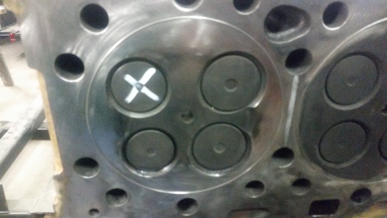

    Ring the head. See the ring around valves. Stainless steel ring pressed in machined grove on each cylinder. Ring protrudes about .005 and locks around outside of fire ring. One person I know who does this. Pm me and I can give you info.

    Also, you see the saw cuts in the head? Those are also an issue for some guys. Those relief cuts are supposed to help with cracks in the head, but actually in my opinion they distort the head gasket when the head is bolted and torqued down, causing problems.
    I agree with what @superhauler said. If youre gonna build one that you want to last, I'd go with the fire ring and get the sawcuts filled in and machined. It's worth the money in the long run.
