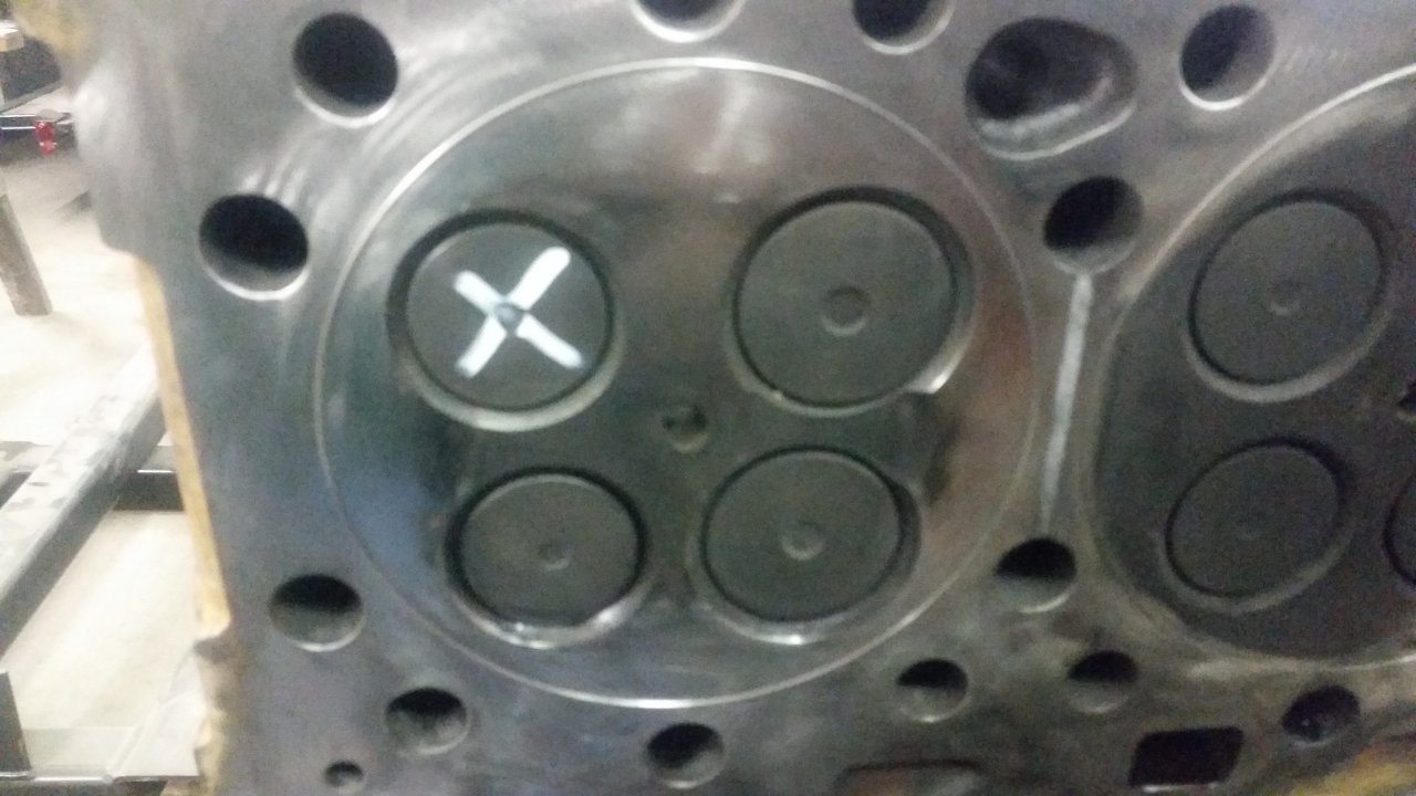

  10. 991lw
    991lw Bobtail Member
    13
    Jan 15, 2017
  11. 991lw
    13
    Jan 15, 2017
    That looks nice,who rings the 3406 e head?
