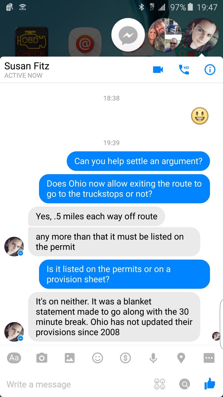

    I'm not trying to pick a fight but this may help someone in the future avoid a ticket. You "permit girl" is wrong, I emailed Mike Moreland with Odot special hauling permits last night and he responded this morning (remember I said I know them) here is what he said copied and pasted right from the email, I left out my part of it because I used my real name if there's any doubt I would be glad to screenshot the whole email and send it to you in a private conversation as long as you don't put out my real name.
    "Permitted loads are not able to deviate from the permitted route that shows on the permit document for any reason except by order of a law enforcement official or the issuing authority. Fuel stops can be included within the routing if ask for at the time the application is submitted.

    I don't run in Ohio much but when I do if there's a need for me to leave the route for fuel, sleep, tire repair etc. I will and once someone writes me the ticket I'll be back in Ohio for my day in court.
    I'm not going to argue it on here, our permit people made a big announcement to all of us when this was done at the harmonization conference and they all remember it so at that time I'll let the court sort it out.

    That's fair enough, but the email I posted is directly from the head of Ohio special hauling permits division. His number is right there his email is right on Odots website he the man who will testify against you if you take it to trial. If you do get a ticket " my permit girl said it was ok" is not an affirmative defense. I will say this is the group of guys who talk about how be have to be better and professional because of what we do everyday. So I want to know the law and make my own decisions, I'm the captain of my ship not my dispatcher, permit girl, or anyone else when I push the yellow valve it's my baby. When I'm wrong I'll admit it, about this I'm not.
