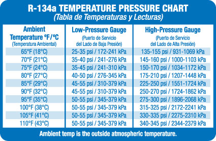

    4CFF0C50-010C-4A09-9D73-37796C402729.jpeg All is normal now. Yes with that temp the high side wise that quickly with the fan in automatic mode. Your system is fine and here is the chart with ambient temps
    Kenllah Thanks this.
