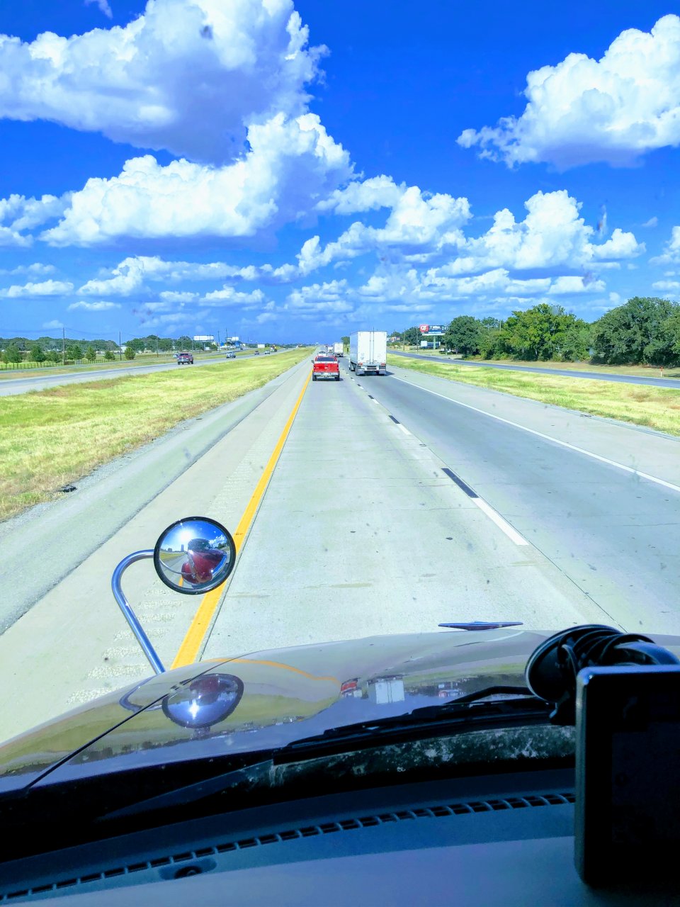

    I had a funny feeling that the whole system couldn’t be 100% disabled since it was a factory option BUT if I could tone down the settings...wayyy down...then that would definitely work for me. The pic above is when my truck starts it’s beeping fit. It may not look too bad at first glance, as that is a pretty good following distance to maintain. However, it’s virtually impossible to maintain this distance 100% of the time because it’s not just my choices....Every time some jerk in a Nissan Altima cuts me off, welp there we go. Beep beep beep! It’s ridiculous
