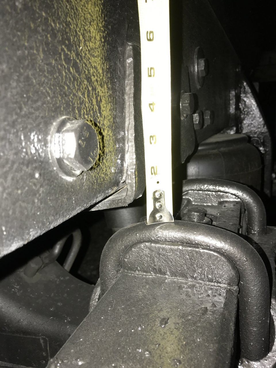

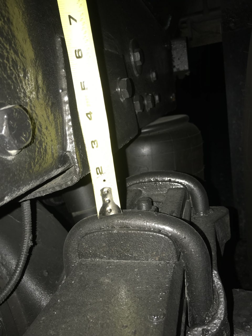

  10. Cam Roberts
    Cam Roberts Road Train Member
    1,621
    1,938
    May 13, 2018
    Ok so mines the same as yours looks likeI have mine at factory height
    Rear clearance picture first and then front
    9229D241-8B46-47AC-88A3-2C934A7DE4EA.jpeg 26D78E13-87E7-4D33-B7C0-B11266B9D6B9.jpeg
    Intothesunset, Grubby and rank Thank this.
  11. Cam Roberts
    1,621
    1,938
    May 13, 2018
    Should be fine. These trucks have a bit of a rake to them. If my truck were to match the same height as the rears, the front end would be way off the ground. I have all new front suspension and basically all new rears. And all new bags. Also had driveline alignment.
  12. rank
    rank Road Train Member
    9,919
    113,510
    Feb 11, 2010
    Yep same as mine. I can see where your front U bolts have been bottoming out on that angle bracket like mine too
    Oxbow and Grubby Thank this.
