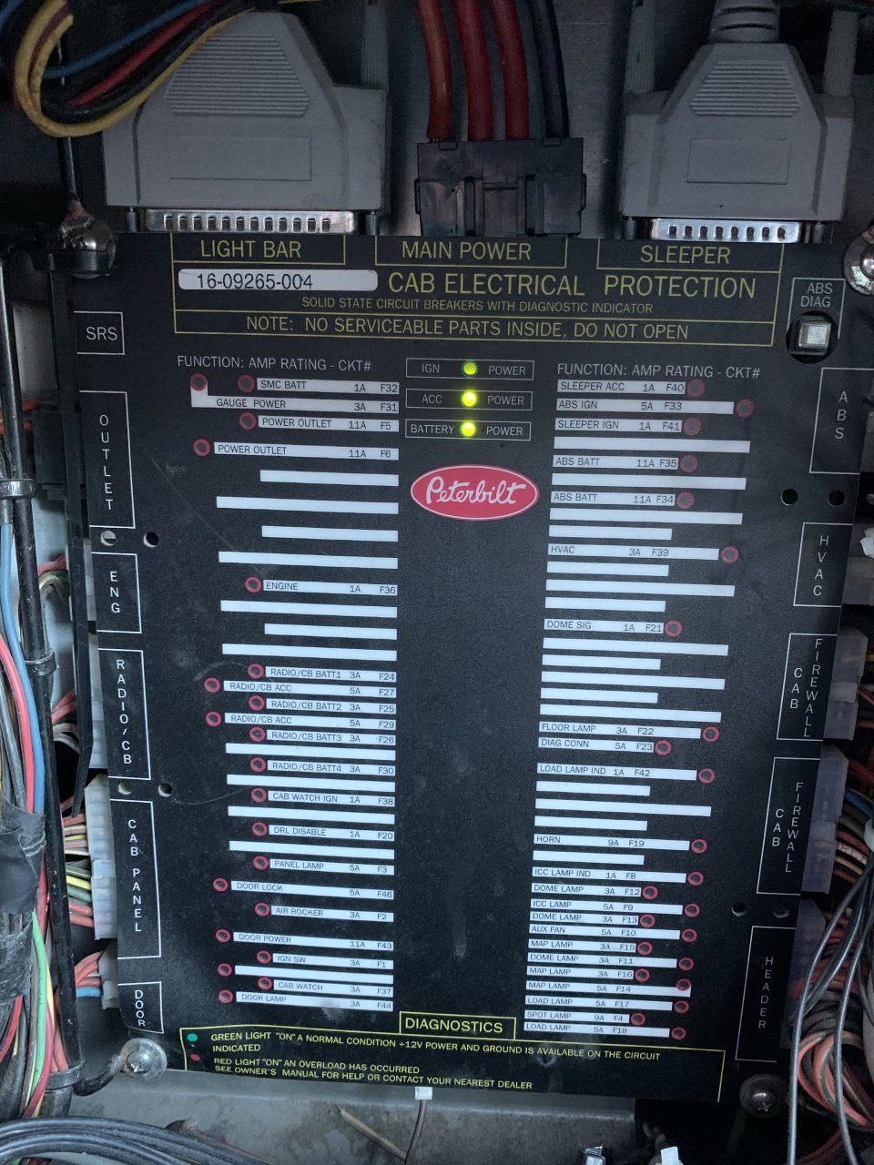

    Help I have a c15 powered 2006 peterbilt 387. The guages have completely quit working no low air warnings nothing. The blinker indicator still works but no high beam or park brake indicator. I have cleaned every electrical part I can think of and replaced every fuse and relay I could find. Any help would be greatly appreciated

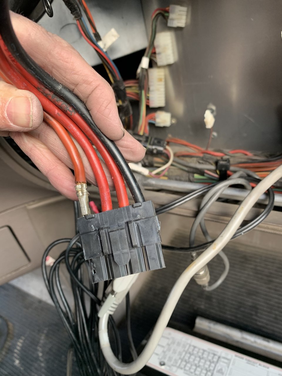

    I had this issue. It’s the power wire to the board. The first wire let’s you run the truck and the second positive wire from the left operates the gauges. It’s the top center plug. Be careful and not to man handle the board. It’s behind the jockey box.
