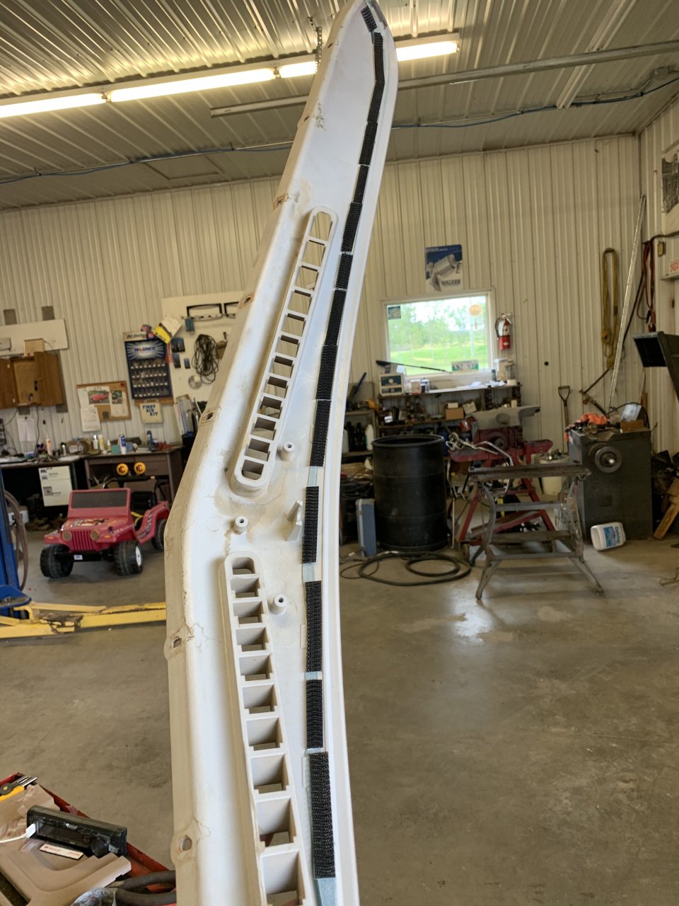

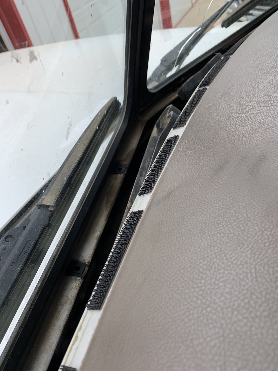

    3F592966-976F-4DE3-A42C-B76DAF8A5599.jpeg I know this thread is a little old but I was looking for help on this same issue.
    What I ended up doing was removing the top dash cover panel since all the glue broke apart and used heavy duty velcro all along the 2 dash parts. It’s is crazy strong and flexible if under stress.This was on a 2009 peterbilt 367. 3621876B-4E8D-4178-838F-183653E70935.jpeg
