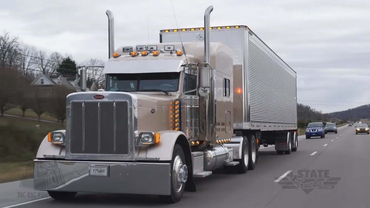

    Getting read to purchase 2021 389 but find the headlights are hideous. Posting a picture of what I want and not sure if this is factory or aftermarket...anyone got some intel for me?

    Those are just 357(?) single squares can try and find a used set they are expensive new

    Yeah those are spendy because they weren’t real popular at the time. Try salvage yards and maybe even body shops. Call Peterbilt dealers and see if they have any takeoffs laying around. As long as they’re not dented they can be polished and brought back to life.

    I have done some searching and found new and used ones. New, I can get them for $1,615 + tax.. Used, there’s a pair on EBay for maybe half of new cost (active auction, final price anyone’s guess).
    Unfortunately the auction will be over before I know if I got the truck.
    Personally, I’ll probably go with new and just sell the ones that come with the truck to recoup some of the cost.
