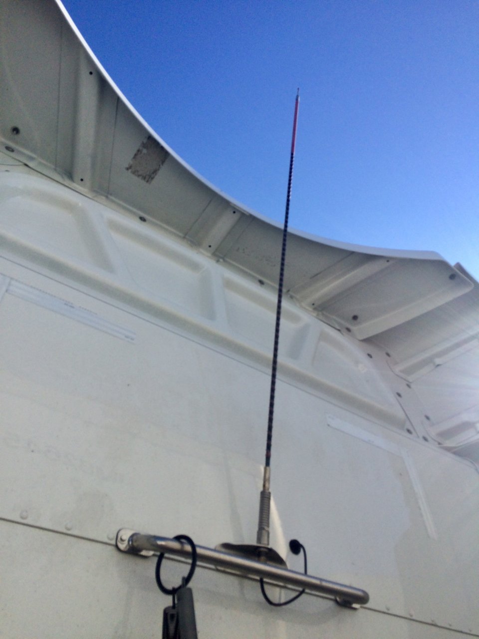

    In the meantime I’m making this work.
    I agree about strength potential on the factory roof option. It’s a concern.

    We got them made for new model Cascadia. What you should be using.
    Just did take-off on 579 a few weeks ago.

    Had a text message today that the 579 mounts will have an integrated stud; so they’ll be somewhat different after all.
    The 102”s are for other projects. But it’ll be fun to test them.
    Went looking today for potbelly SS spring. High quality. Found them. CAL-AV. Start at just over $100 (wow).
