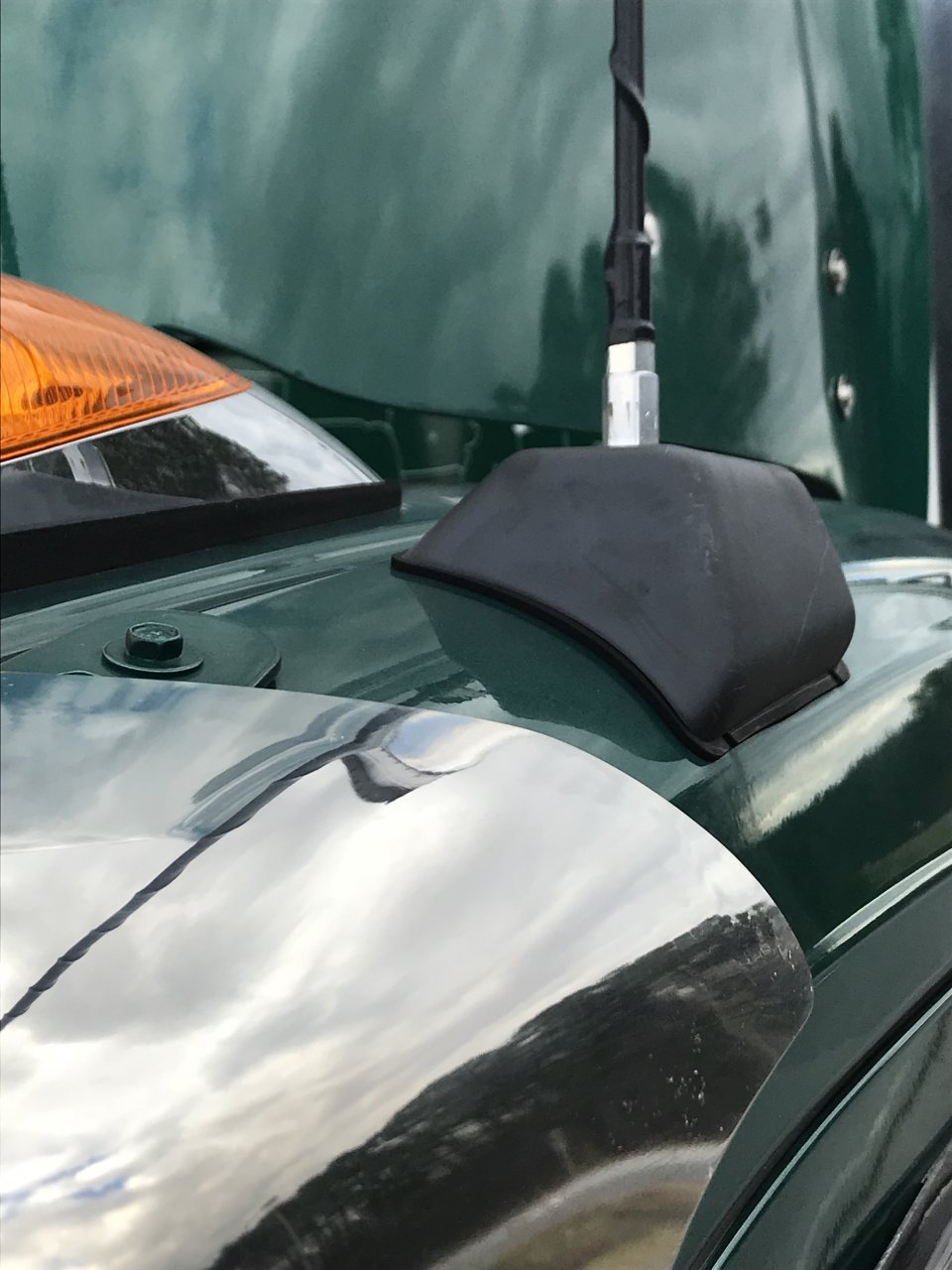

    I did. Your cab looks taller than mine, with your antennae attached on the corners, sort of.
    I’ll get you a pic of mine tomorrow to illustrate.

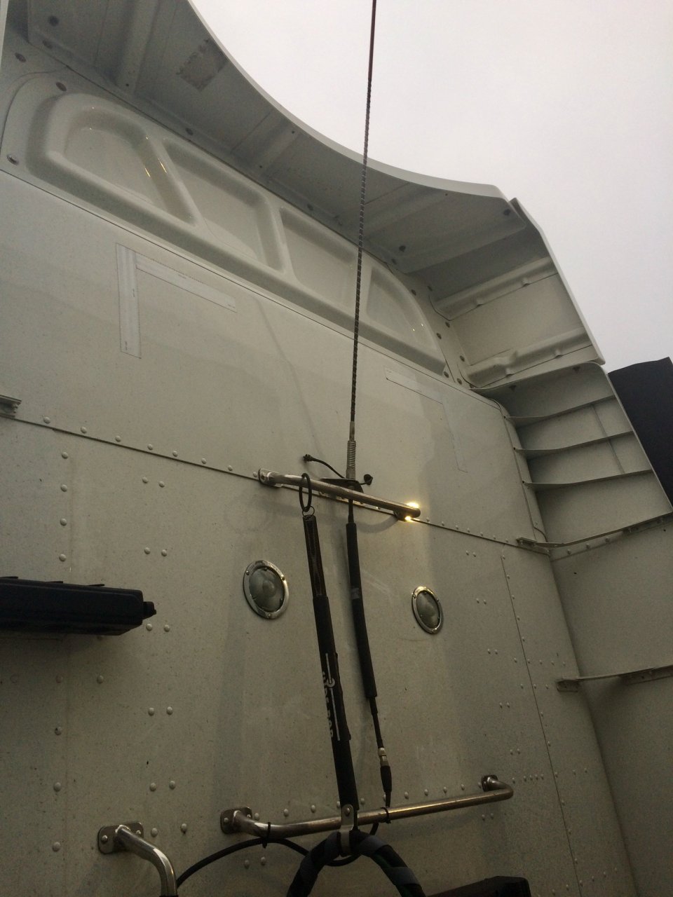

    (Post 23 shows my back of sleeper factory mount. Otherwise a standard 579 EPIQ. )
    I finally ran RG8X thru the cab and under the bunk exiting thru an existing inverter-lead hole in the side-box floor.
    Have run some fused 6-ga stranded to jump points as temporary.
    Both the coaxial cable & power leads are encased in split loom. And both are treated AT EACH END with a choke or filter:
    1). Big DC toroid ferrite at entrance to cab, and Palomar 12VDC filter ahead of Rig Runner distribution panel.
    Palomar Coax Filter at Radio and their FC-8-15 Choker at antenna feed-point.
    NOW that 5’ Skipshooter can perform.
    Have been running the Galaxy 99v2 wide open on Gain & Squelch except when thru big metro areas. “Known” base station signals at 25-30/miles on IH40. (Adjustments to DSP Speaker filtration level minimal thru day).
    More bonding needed (90w Forward & 1.0 Reflected using MFJ tuner with minimal inductance).
    So it’s great to maximize reception (per se) given the wait for SS mirror mounts.
    And there wasn’t a single minute of a 500+ mile drive yesterday without radio chatter.
    Granted, IH40 Little Rock to IH24 Chattanooga has heavy truck traffic. Plenty of locals and short regional. But the quality of the rig & install DOES have something to do with, “there’s no one out there”.
    Just need to seal up the connectors with Coax Seal, Super 88 and some self-fusing UV resistant tape.

  6. MACK E-6
    50,203
    240,157
    Sorry, I forgot.
    Yeah it definitely looks like your cab is taller.

    That looks like the red 579 stock photo (not mine) I linked very early in thread.
    The only configurations I’ve seen have been that type either dual or single (on gliders), or, the sleeper-back as in our fleet.
    Buy/build some caps to plug those with those antennas stowed.
    Robert said it’ll be a bit, but the mirror-mount bracket SS antenna mounts are coming (CLAYS RADIO SHOP).
