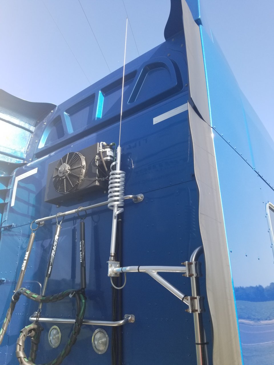

    I have since ran all new coax cable in my 579 the factory cable is crap couldn't get SWR's below a 3. I mounted my antenna on the grab bar on back of sleeper with an extension (will post a pic later) SWR's are now a 1.2. I'm using a Stryker 650HP, was using an old school Galaxy 66V and a also using a Texas Star 500wt linear.

    That pic ever become available? I just moved into a 579 with a back-of-sleeper-mount single antenna.
    How did you run coax, and how much was needed?

    It took me 45' of coax. The route I ran coax was a long one. I had an APU installed on my truck so there was a hole in floor under bunk centered on back of sleeper wall where I ran cable up thru from antanne. I ran it under floor mat in under bunk storage (had to use hole saw to make hole big enough to fish coax thru bunk metal wall coming into sleeper (still under mat) heading to wall behind drivers seat to the door threshold drivers door ( you have to gently pry up metal tread on threshold, it snaps in place to access mounting screws ) run coax under threshold and up wall between body/inside body panel heading up wall towards airhorn pull. Now this is where it becomes a pain in ###. You'll have to cut off coax end to fish coax thru body panel where airhorn pull is ( like about a 1/4" of room to work with between body and body panel) once fished thru there run coax thru upper dash to CB and then a trip to CB shop to have a new coax end put on and have SWR's set. It took me about two hours to do it, save some time just cut one end off coax to route your wire. 20180825_085958.jpg 20180825_090003.jpg

    I screwed with it for about an hour (with coax end still on) just cut it off much easier to fish coax thru panels without it.
