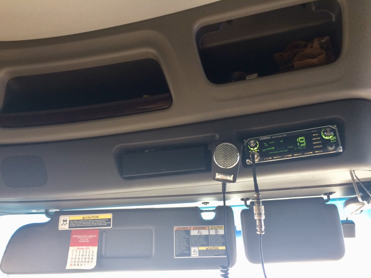

    A little late with the picture because I forgot, but here’s mine.
    stacks and Slowmover1 Thank this.

    I prefer to hang my cb in place of the center sun visor like I did in my T880. Just have to make 2 small L brackets. Looks to be a little more room in the Pete's upper cabinet for a bigger radio, but still have to do some cutting I guess. The KW won't fit anything with a bottom amp. And their external speakers are junk.

    2016 579 Pete
    Uniden 885 CB/Scanner (GPS and Scanner antennas on windshield interior per that factory).
    RM Italy KL203P amp atop radio case (not shown behind panel)
    Astatic D104 microphone
    Factory speaker far left
    Out back is a Wilson 5’ Silver Load
    Using all factory connections, coax, etc, at this point.
    stacks Thanks this.
