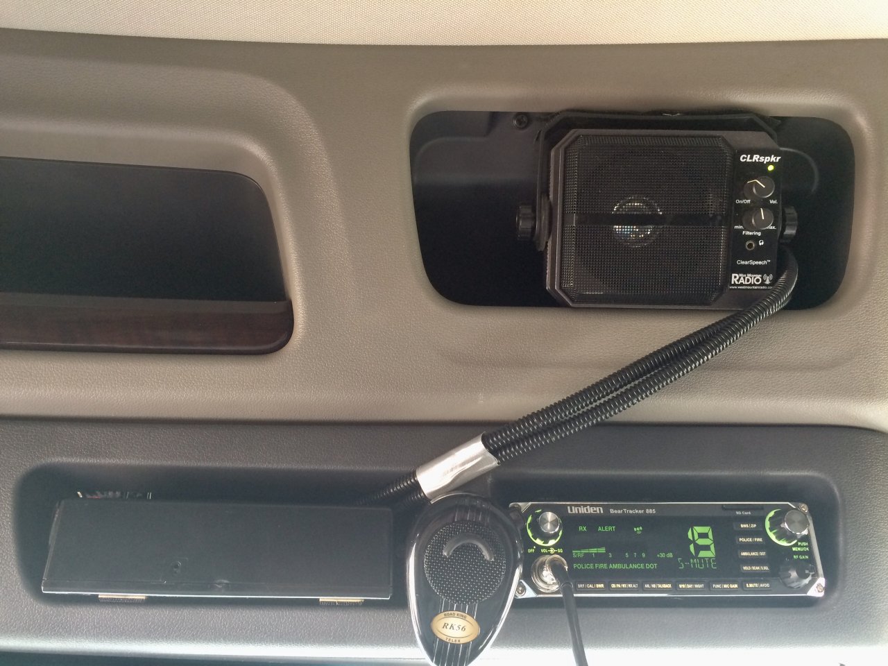

    Here’s a good pic of the
    1). UNIDEN 980 AM/SSB Radio ($125) with an
    2). RM ITALY KL203 70w amp ($75).

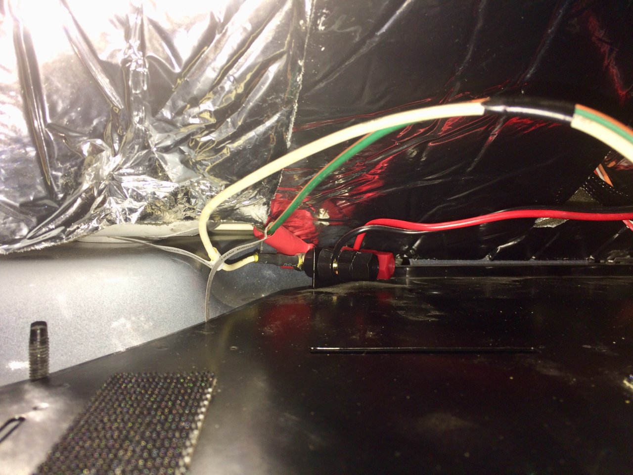

    The amp will be hidden behind the 579 fascia panel. 12A fused. Amp & radio will run off factory binding posts.

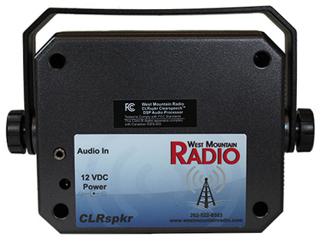

    A better pair of pictures of the
    WEST MOUNTAIN RADIO CLEARSPEAKER ($199)
    This cleans out so much noise that you won’t believe it.
    (No, your Galaxy, Stryker, whatever, isn’t a substitute. They’ll benefit as much).
    On a good night I can run radio wide open. Voices on top of voices. Coast-to-Coast Skip.
    Radio + Amp + DSP Speaker = $400
    No $400 CB or Export will touch it.
    Oh, but you say your radio pushes 250w? Won’t move the meter any farther than this baby. Jump to 600w for that.
    And those big wiring headaches for those radios and amps. Fire Hazard. CPU/ECM interference. Etc. This rig runs all the gear off of single power harness from factory 15A circuit.

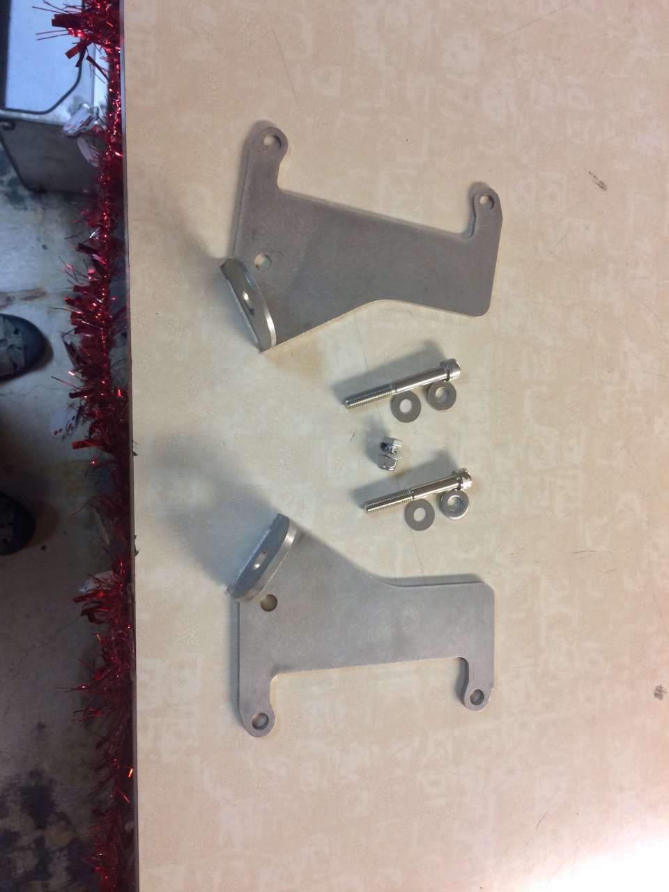

    The SS F2BF290F-4D35-43E5-A6D6-282E1C9D654B.jpeg 579 brackets will be similar to these New Model Cascadia ones we did last year.
    An RG8X co-phase coaxial cable harness should be easy enough to use to connect a pair of 7’ Skipshooters with these brackets.
    It’ll definitely beat any of the factory mounts.
