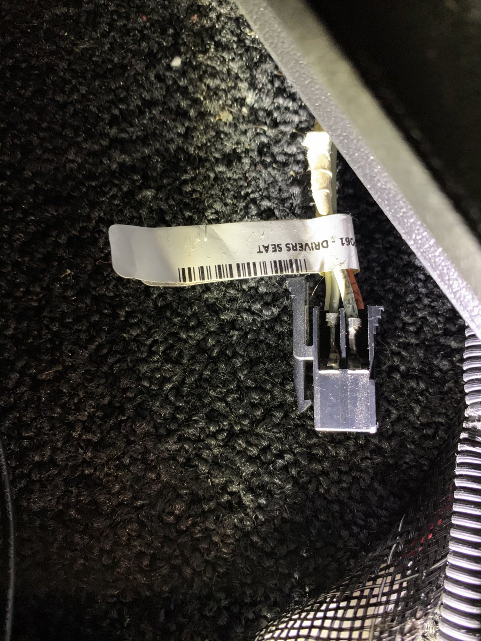

    I have a 579 and a Minimizer seat that needs power
    In my last truck I just added a new fuse and ran a wire back to the seat
    I have this connection that’s already behind the seat and assume it should be hot or able to be but either I am not getting a good ground with my test light or there’s a fuse for it that needs to be installed
    Any ideas?
