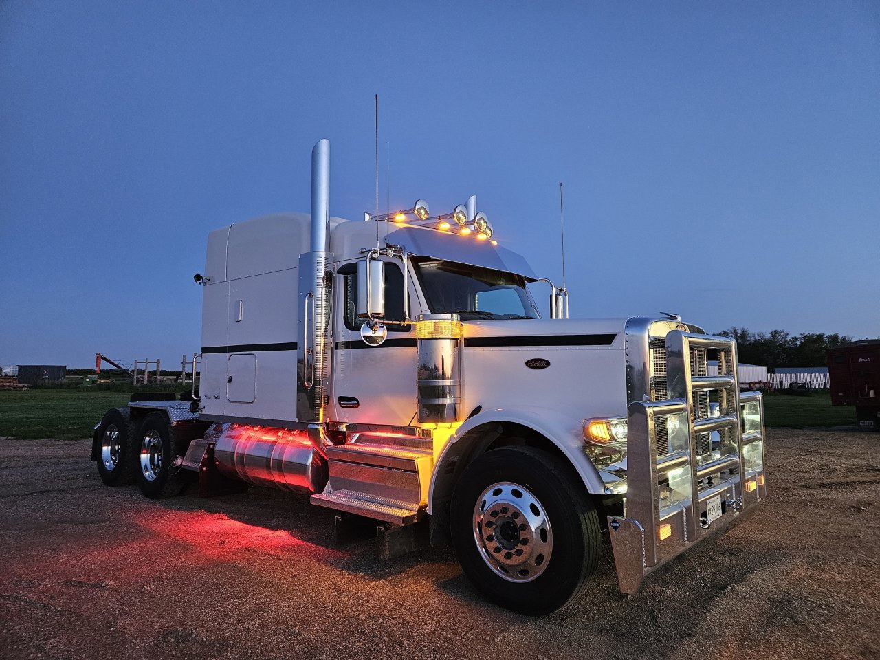

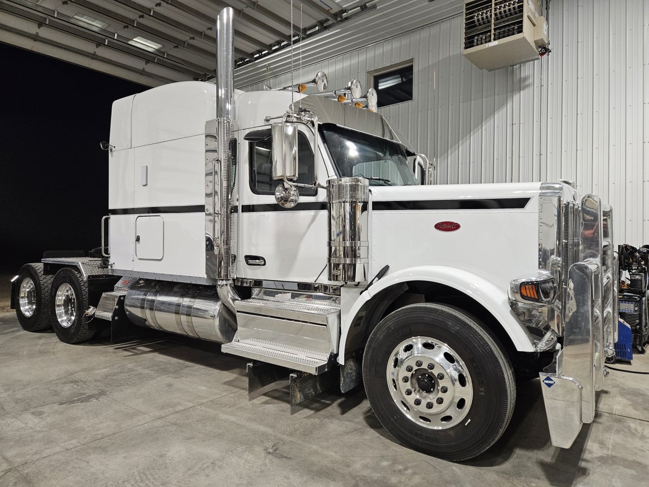

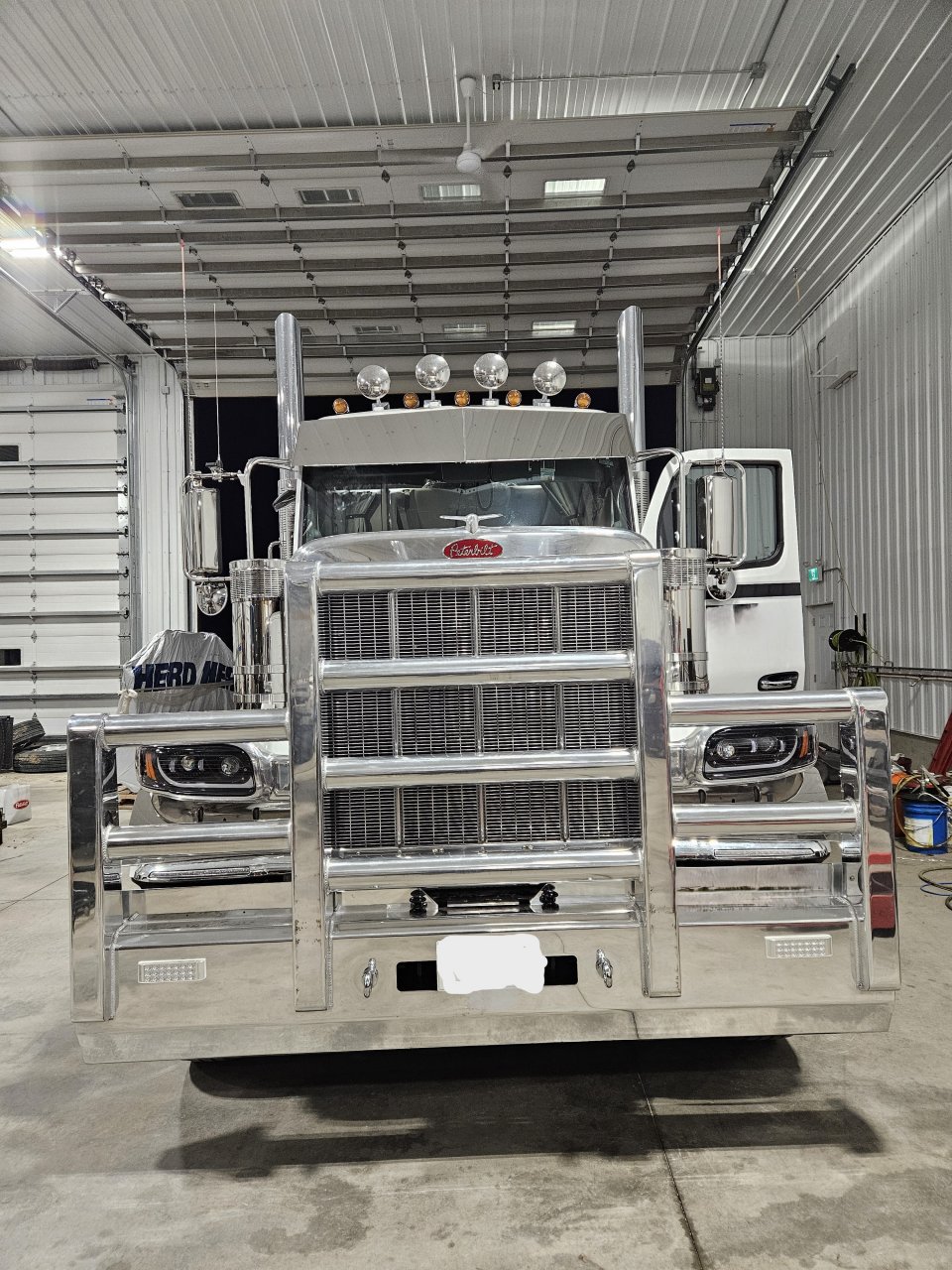

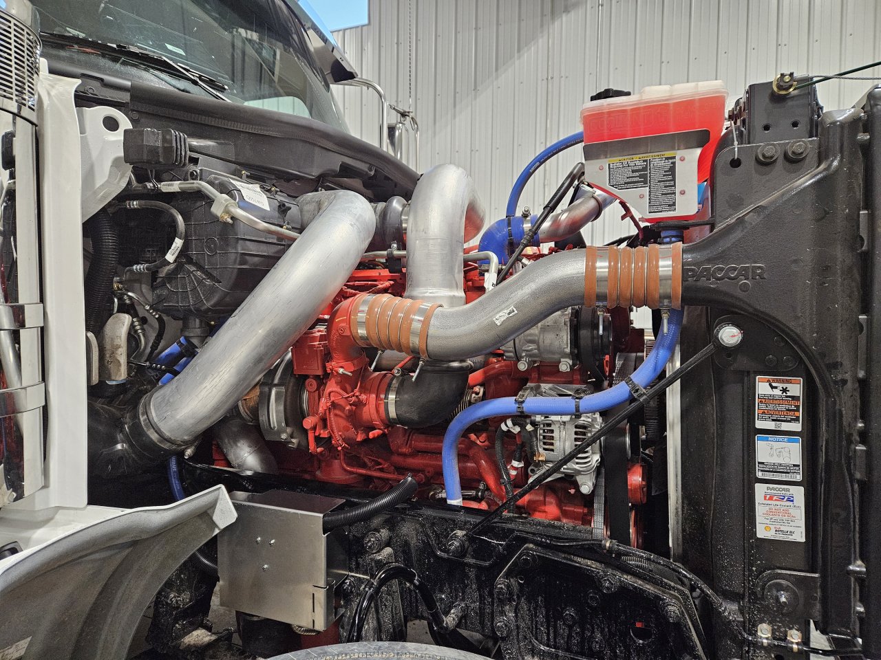

    Trux headlights, pete fender guards, 18'' drop visor, pete air cleaner lights, red underglow, new style herd bumper

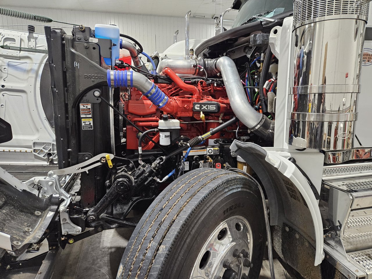

    20240620_224858.jpg 20240620_224907.jpg 20240620_221139.jpg 20240620_221219.jpg Air piping is complicated. No room to run the air cleaner hookups in the cab like they used to. Shield on frame covers a webasto

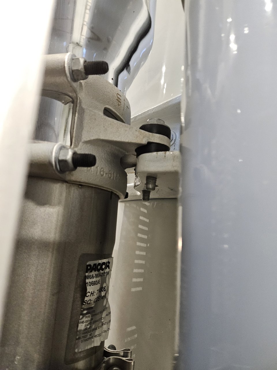

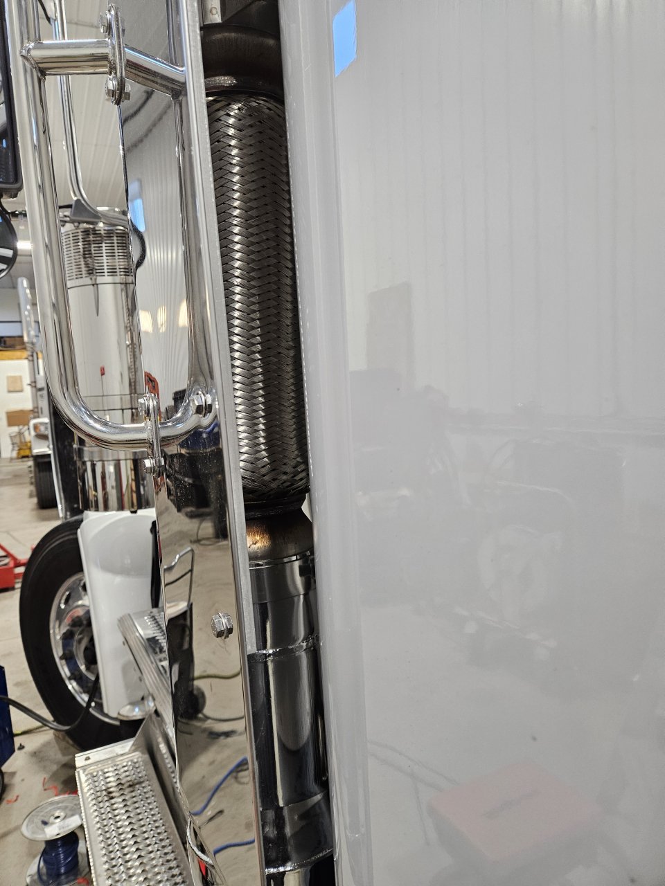

    Stacks are finally fixed. No more sliding bushings that always bang and wear out. Stacks are hard mounted to the cab, flex pipe at the bottom of the stacks.

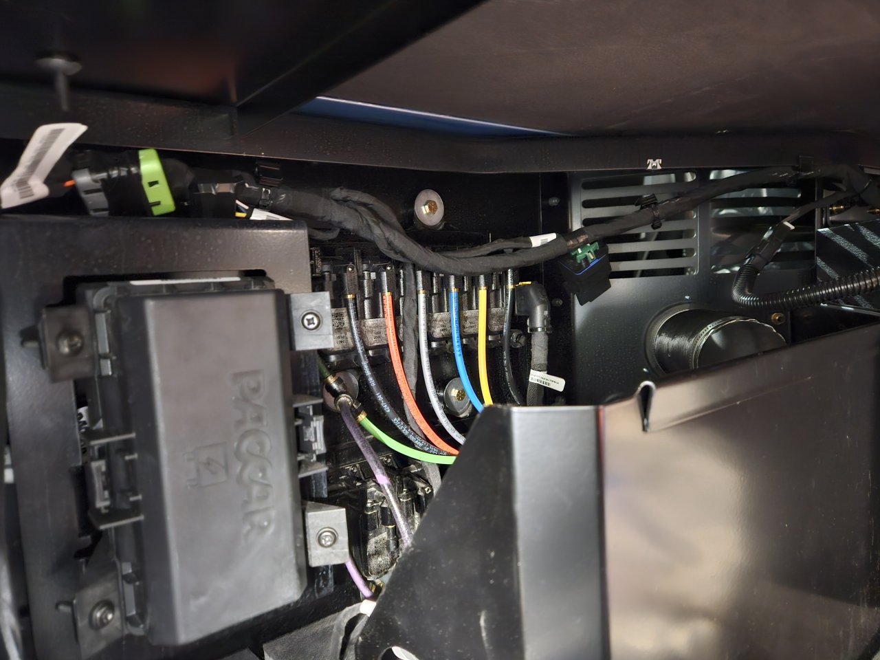

    Relocated the air solenoid banks into the sleeper. Stops the valves from freezing, plugging with mud and rock damage.

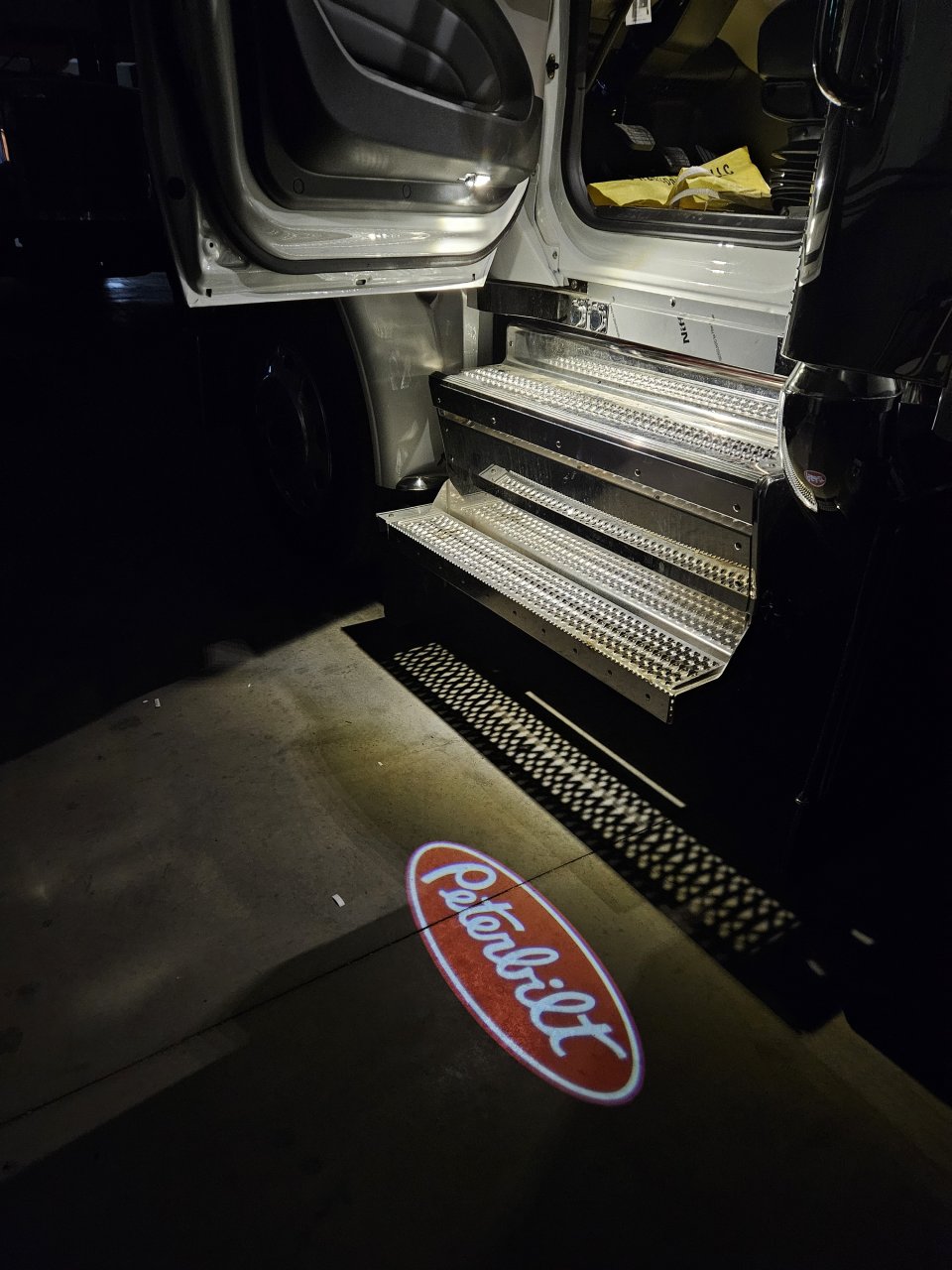

    Best peterbilt accessory yet. Puddle lights that replace the factory door lights and project the peterbilt emblem onto the floor. For 160$ they are gonna sell a ton of them.
    Flex in the stacks.

    Are both stacks functional, or is one a dummy? I still don’t understand the breakdown on the dummy stacks…..
