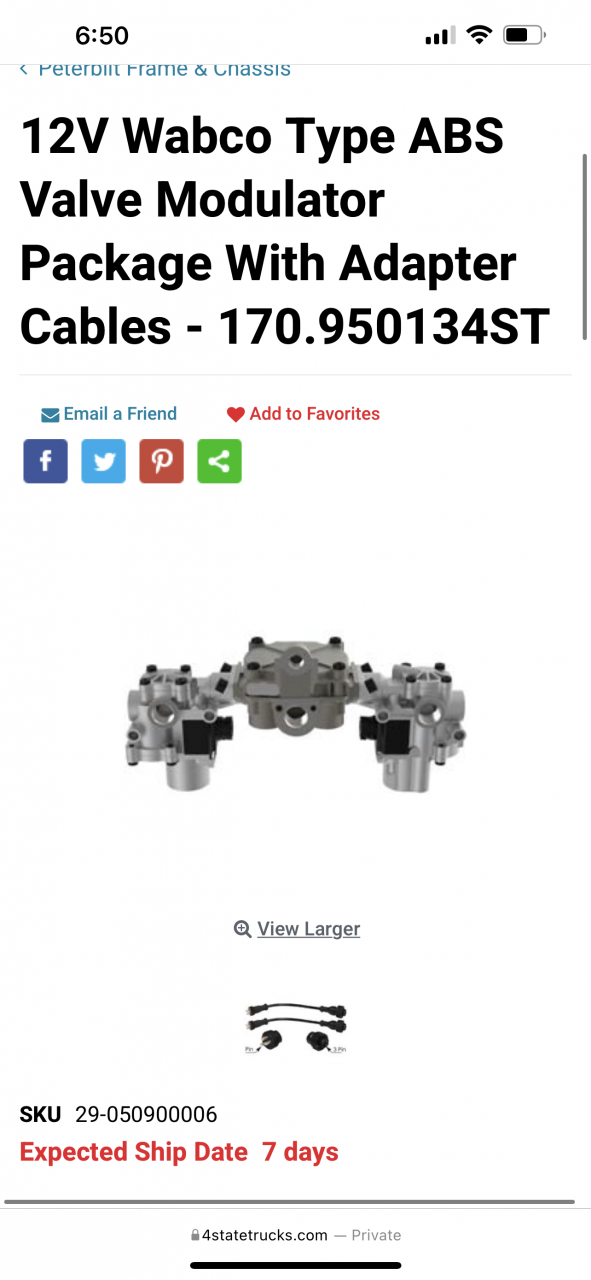

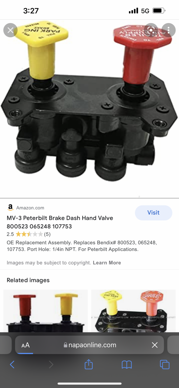

    Have both valves leaking when I release tractor brakes. When I push on the brake pedal it stops. I’ve loosened up all the service lines on the brake chambers, they’re not pushing any air into the service line. I then changed abs valve, nothing. Now changed dash valve and again, nothing. What else can I look at?

    ABS valve under fifth wheel between tandems and dash valves. Both leak as soon as I push yellow in. Press the brake pedal and it stops while pressed in.
    Started suddenly

    ABS valve is from vent on bottom? Dash valves leak air from where?

    Really wondering if air is leaking from the dash valves or if you just hear air flow through them.
    I would start with crimping off or disconnecting drive axle service hoses one at a time. That is while leaking looking for a bad chamber.
