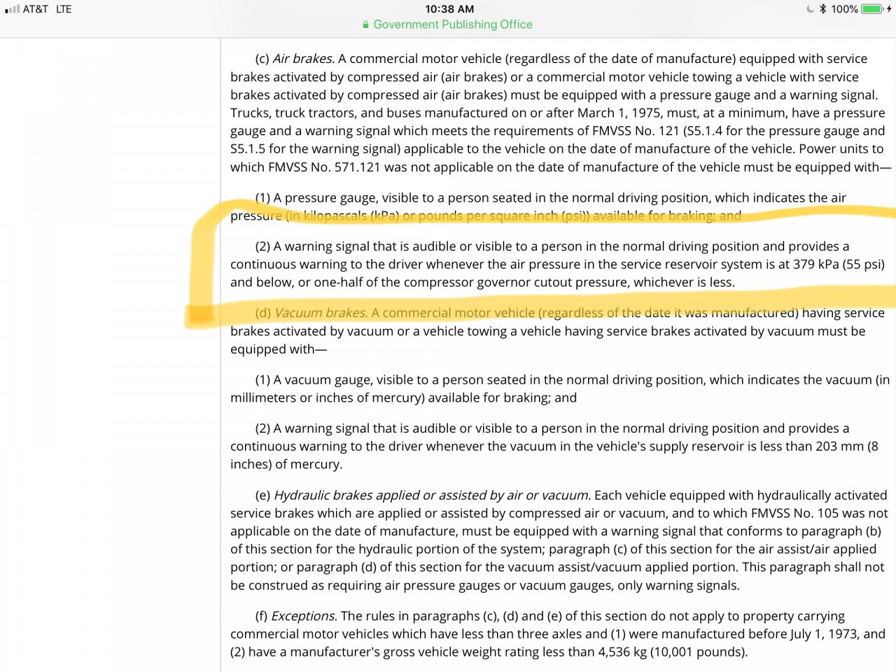

    They have a habit of going off at random. Mostly from leaking windshield.
    The book says you have to have a visual or audible warning.

    The buzzer on an 88 Pete is on the back side of the idiot light cluster in the dash. That maybe the pressure of switch that tells the buzzer to work. The law states your required to have a low air warning light and buzzer. I don't think it an and/or buzzer

    ok sounds good, im just gonna leave it and if asked ill play the its to okd never had a buzzer just light
