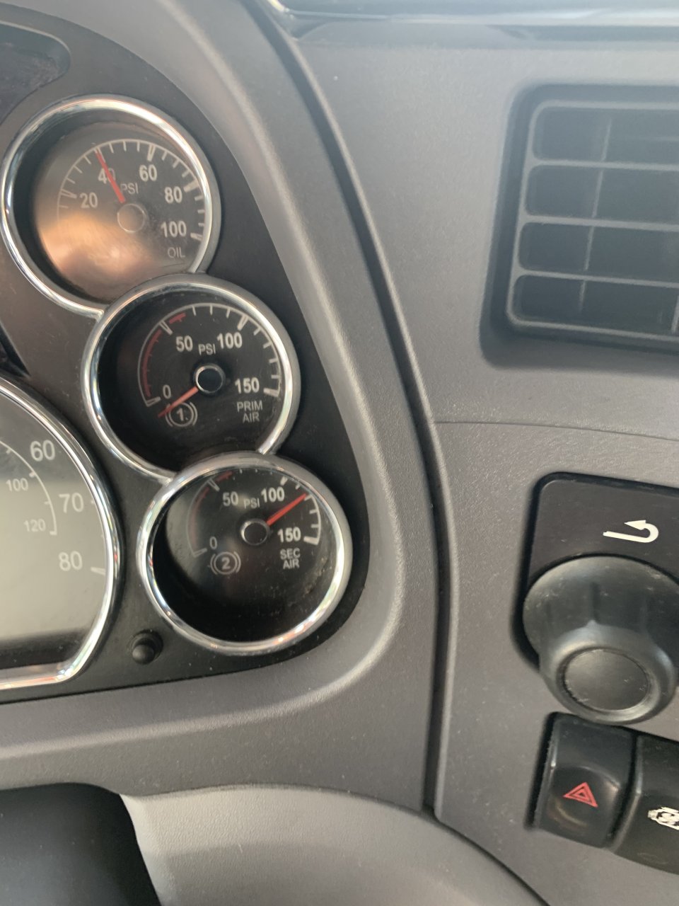

    I have a problem with primary air gauge, the gauge won’t go up but there’s plenty air in the system can someone help me on this
