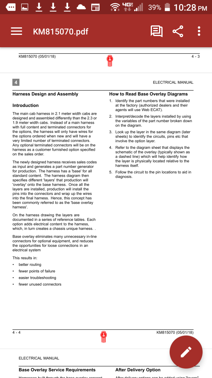

    You sure about that?
    I think i would look first. Looking at the diagrams you get one or the other. Cab computer needs to get programmed as well

    I would be willing to bet there is only one cab harness used on all common cabs. My current T600 cab harness has plugs for switches and gauges for stuff that usually only found on a KW C500. Having Reprogramming the cab controllers might be a possibility. That's why I posted the question to see if anyone has done this yet. Thanks for the response, I appreciate it.

    That used to be the case for cab harnesses but not anymore. Harnesses are specific to each truck and dont have any extra options there.

    Screenshot_20200702-222853.png 2.1M cabs don't use the same instrument panel harness in all builds like 1.9M cabs. Wire, terminals, and connectors are expensive.
