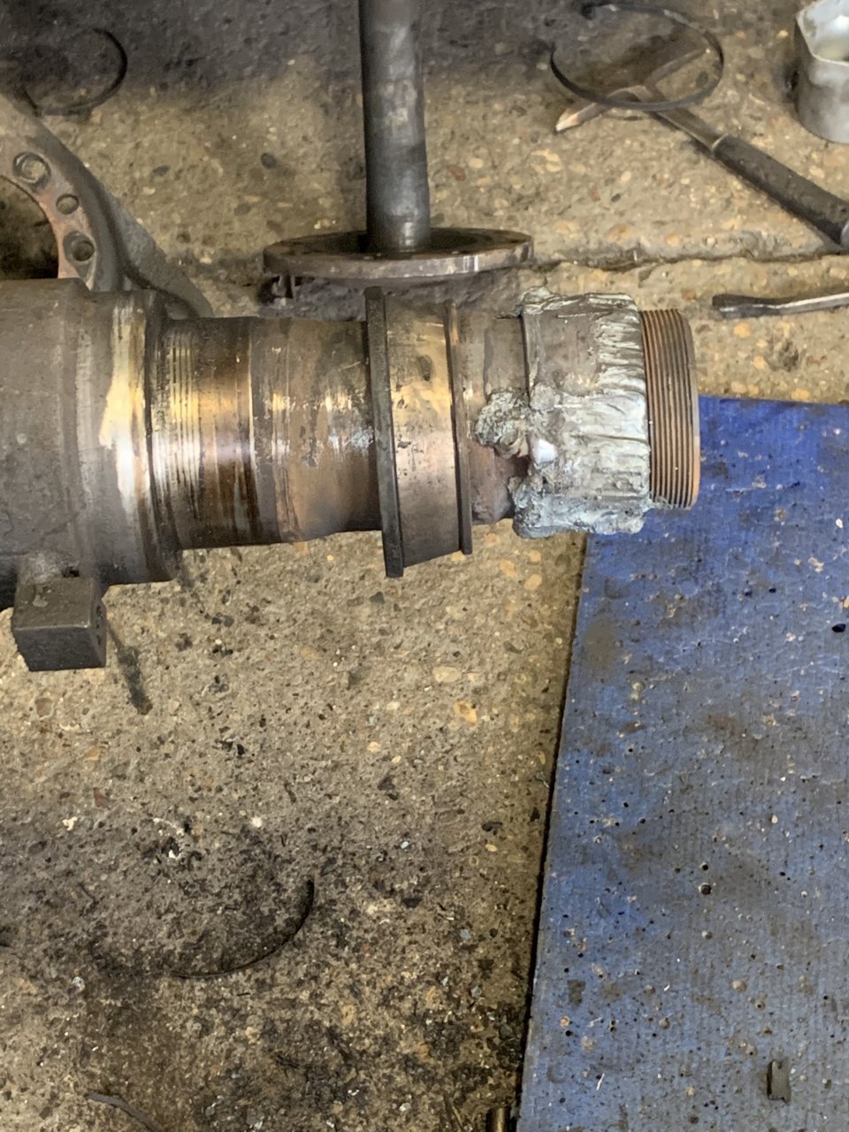

    Rear end was full of oil. I had the first shop top it off, but the bearings were burned dry when the axle was pulled.
    New bearings and oil change before I left home. Think they didn’t torque the bearing properly. Makes me look at everything they touched everyday.

    Had exactly the same thing happen to me on my 1978 IH 4070B in 1980 at an International dealer. It cost them $3400 in tow and repairs, had to replace the entire rear end housing. That is around $12,000 today. Nothing new in the truck repair business.

    You're lucky Mr. hot-wrench didn't ruin your housing entirely.
    I did a 4,000 hour Tool and Die Maker apprenticeship in 1971
    at Mc Graw-Edison. Yes, thats four years.
    Never regretted a minute of it.
    They make a neat tool now that is an air die grinder for wizz
    or cutoff wheels, but its extended, about 12 " long,
    and the spindle has a 90 deg. gear-head, with a collet at end.
    So your cutter is straight in front of you - for more control,
    and doesn't cut in, and spin out sideways, if it catches,
    like normal die grinders do. Would make this bearing removal
    a piece of cake. No heat a plus, too. Make 3 cuts almost thru
    at 120 degrees apart, and wack it with a brass bar/BFH hammer.
    Pieces fall on floor. Never touched the housing or heated it.

    Axle surgeon replaced spindle. Cut it off with a band saw in a jig that mounts to housing. They are the best, this guy has 30 years experience
