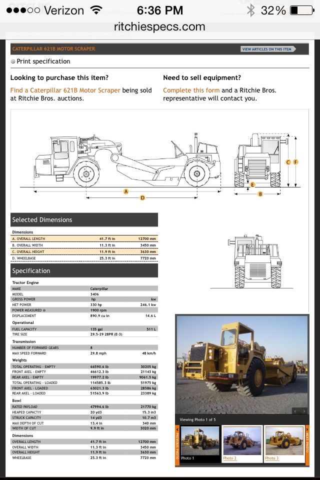

    Heading out to pick up a CAT 621B scraper tomorrow morning.
    I did one similar to this back in the early 90's. We used a short 'Dolly' style trailer and let the back half of the scraper trailer behind on the ground.
    Picking up in Arkansas,.. dropping it in Texas.
    I've got 25' well,.. 4 axles on trailer, 2 drop axles on tractor to make a 9 axle set up. I can stretch out the well,.. but carrier wants to avoid needing pilot/escorts if possible.
    My concern is carrier says to run it up on the upper deck of the back end of the trailer and secure it down that way. Thats fine,.. but if memory serves correct,.. 621 is almost 12' tall. Rear upper deck is about 3' when I lower the ride height. Thats as low as I can get it back there.
    Also,.. AR only allows what,.. 67k on quads? So I need to watch my weight there as well. I dont think loading it with the engine to the front will work,.. will be too heavy on my quads.
    I tried looking up pics on google,.. not much success finding what I am looking for.
    Total weight of the machine is supposed to be 67k. Compared to what I have been moving last couple weeks,.. it wont be too heavy.
    Thanks in advance.
    Hurst

    I'm familiar with the machine. I have the dimensions and specs.
    Just needed loading advise on how to load it on the trailer.
    I've found what I needed now. I appreciate those who chimed in.
    I wasnt sure which direction to load it.. whether I needed to keep it in the well or to utilize the rear deck.
    Putting in on facing forward. Stretching the trailer 1 pin. Rear tires on upper deck.. but letting the belly lay on the lower deck and edge of upper deck. Chain it down that way.
