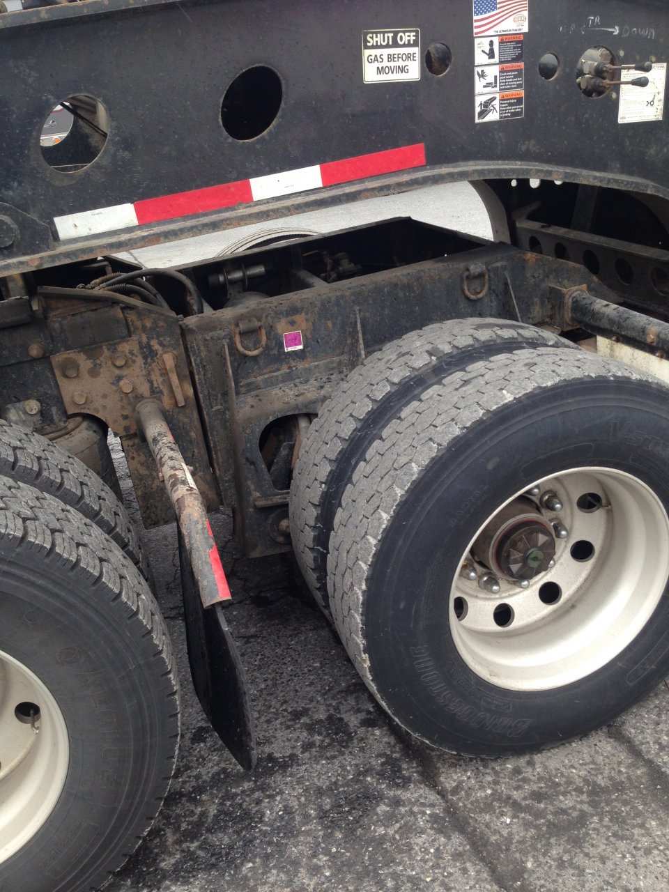

    Yea we use them primarily as lowboy trucks pulling four and five axle lowboys. They can be a bit of a ##### in corners and are absolutely useless in the mud as we get stuck on the dead axle in the back. If you do it you should seriously consider a dual tired steerable axle as they are much better in the corners and be sure you build it as a lift.

    Like @haulhand said. My interest in a Pin on third axle is for use pulling a 3 axle 48x102 flatbed. Already have a high enough deck height. Don't want it going higher.
    If I had a pin on third axle it would probably put my tare somewhere around 42-45k. That increases my payload from 80K to 90-95k on a 3 axle flat. My trailer is rated for 100k in 10ft. Gross weight would be between 135-140k max depending on how far I could slide under the neck.
    Right now for those 90-95k loads I have to run my really big trailer with at least the booster and possibly even the jeep. Would save a ton on permitting and escorts to only have the Flatbed.
