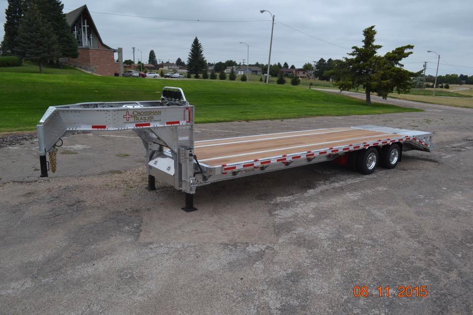

    They don't seem to have a website but I found a couple pics. Pretty cool looking

    The owner was previously an engineer over at Wilson trailer, the ones who make flats, steps, pneumatics, grain wagons. Im sure you know the company..
    What was supposed to make the Crossman so good was there are no welds on it except the rub rail, everything else was huck bolted. You can see some evidence of this on the neck of the pic you posted.
    They were super spendy, IMO, around $35-$40k when I enquired few years ago. They probably didn't sell a whole lot because of that. A 40' flatdeck rated @40k lbs gross weighs about 6500lbs.. Too bad.
    Should have looked before I posted. Looks like back to Alum-line. My post came off weird, didn't mean alum-line was a bad product, but I thought Crossman was a cut above.

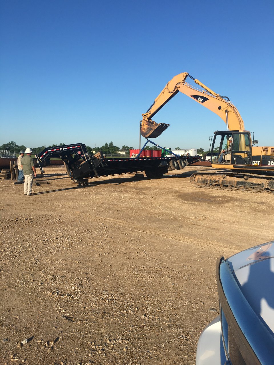

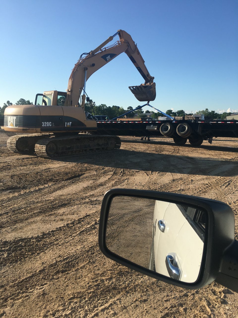

    UPDATE.. Trailers are getting flipped on they're sides, every weld on the bottom getting x-rayed and dye tested Tuesday. Found atleast a dozen more cracked welds just getting under it with a creeper. Can't believe the non craftsman ship and horrible welding they push out the door at PJ trailers.

    And so the fun starts, sandblasting the welds for the x-ray crew and then a look over from a metallurgist to write up a report for the court. Having a closer look under here really shows how poorly these 2 trailers were built, They're gonna get someone hurt or killed putting stuff like this on the road.
