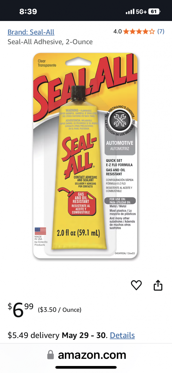

    A8C87233-03B4-46BF-A4FE-A231A99AB5FF.png I’ve used this twice on automobile gasoline tanks. Dime sized rusty hole. Gooped it on, covered with a small metal patch, gooped some more over that. Sold the car today. Still not leaking after 20 years.
