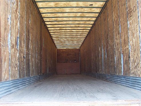

    Plate trailers have very smooth inside walls so shippers are less likely to damage product when loading something that is going to rub the wall:
    This opens the door to lightweight loads that cube out -- like Styrofoam cups & aluminum cans:
    At the narrowest part, the lower forklift skid rails, my trailer measures 101.25"
    It is 101.5" between the walls:
    But the outside is not as smooth as other trailers:
    Anyway, I don't believe there is anything inherently weaker about plate trailers compared to wood or plastic -- my previous plate trailer, a 1998 Monon, is still on the road hauling carpet -- snag free: [​IMG]
    Plastic composite trailer (smoother outside than in):
    Plywood walls:
