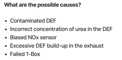

    Here is what someone else said for the same code. I saw several say it ended up being the SCR. But it can be so many things. Reading will tell you this is one of the toughest codes to solve.
    What's causing my repeat code 3582?
    My shop has done several of them for repeat 3582 codes. It could just be a NOx sensor on the fritz, but more than likely if you have the NH3 sensor still installed it'll end up being your SCR cat.
