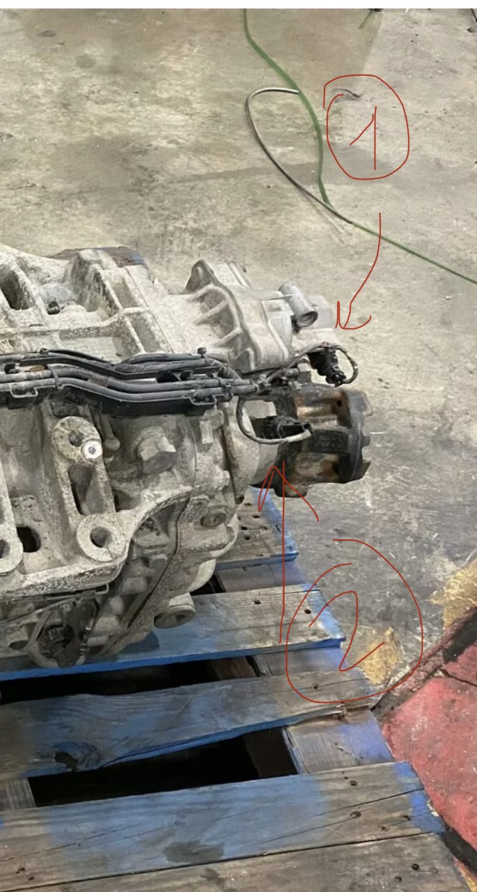

    Have you looked at the rear off the gearbox?
    Should see the speedsensor.
    Warning
    if you disconnect the speedsensor i would only use the gearbox in manual.
    Not let it work in auto.

    Which one is the speed sensor? That’s my last option to try.

    I would disconnect #2 BUT be carefull.
    I don't know how the computer will react.
    If you cannot put the gearbox in manual.......................i wouldn't do it.

    If it is about no speedometer and manual shifting not the big deal. What did u mean about reaction of comp? Who ever tried or heard about speed sensor trick on dt12?

    It might be the computer uses the speedsensor for the shifting.
    I don't know.
    It is worth a carefull try.

    1 is the speed sensor the other is the cruise control

    #1 on pic is speed sensor? And #2 cruise...can i unplug both?
