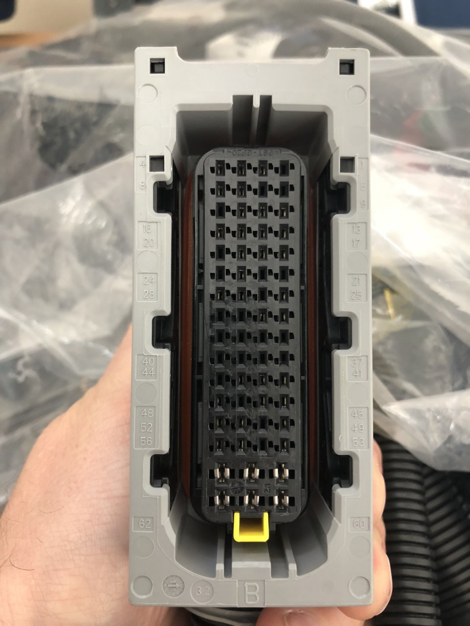

    Check the resistance on a pin 26 ACM and pin 3 by the sensor on a plug. Ignition key off.

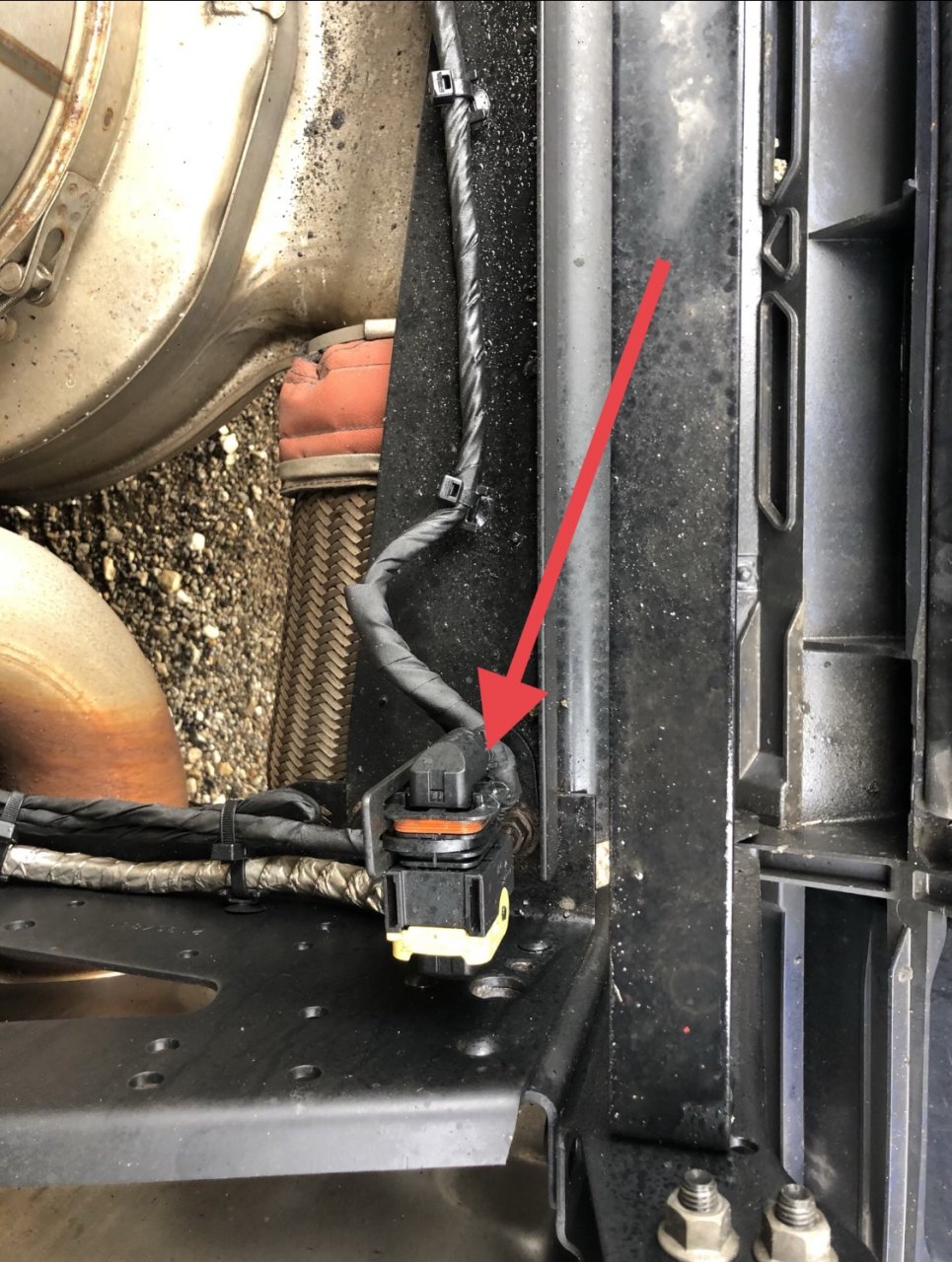

    49474114-9896-4FA7-8AAC-CA9B935349BB.jpeg There’s one more connection point between all the sensors on dpf and ACM and pin 6 is Signal from dpf differential pressure sensor. Measure resistance both ways to the ACM and to the sensor, wiggle the cable at the same time might help. Ignition key off.

    ok...first things first. measured resistance from acm to dpf pressure sensor. 5v supply had no resistance, sensor wire had no resistance, I could make no connection from pin #2 on sensor to pin 24 at acm
    nevermind...its 54 at acm not 24
