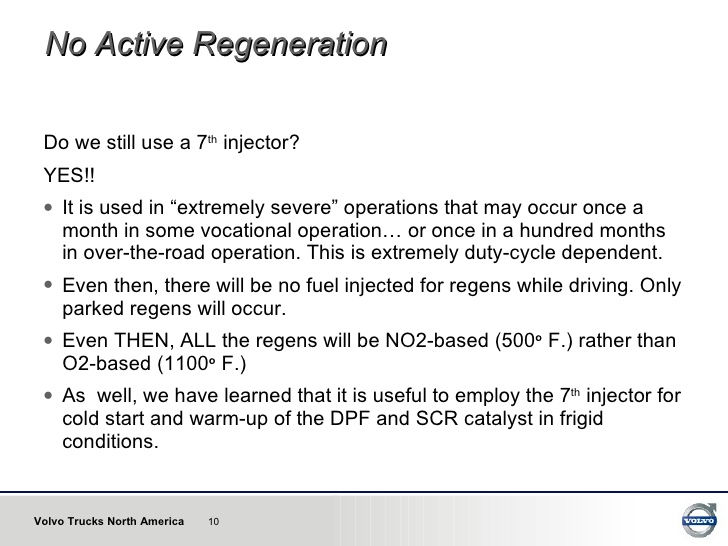

    I was under the impression the 7th injector was only used during a forced or parked regen. Am I wrong?

    In my 2010 , the 7th injector also opens driving down the road during active regeneration , "Regen in progress" msg pops on dash ,every aprox. 2000 miles runs for 20 min, and shoot level resets if all works ok,; If i need a parked or forced i know something is wrong , this two modes are kind emergency features to keep you going, i doubt AHI is there for this reasons only.
    I'm not familiar with your truck, not sure if you are right or wrong, i understand from 2011 they eliminated active regens, but from i read in the link above , AHI module still injects fuel in exhaust if needed.
    "Over time, the amount of soot on the DPF will build up the point where regeneration is required. In many cases, particularly if the vehicle is operating at higher speeds on motorways, the exhaust temperature alone will be sufficient to cause the oxidation of the collected soot. However in some instances there may not be sufficient exhaust heat — when the vehicle spends extended periods at idle or low operating speeds or is operating in low ambient temperatures — to trigger a needed regeneration. The integrated AHI system has been specifically designed to compensate for those periods, the company said. Controlled by the engine’s electronic control unit (ECU), the AHI system receives a signal when it needs to dose the hydrocarbon — diesel fuel — into the exhaust stream. The signal will open a series of valves in the unit, which injects the fuel into the exhaust. The fuel reacts chemically with the hot exhaust gas, which raises the temperature of the exhaust significantly, causing the soot on the DPF to be burnt away. The overall aim, Racor said, is to have the capability to burn off excess soot no matter where or how the vehicle is operated"
    https://www.parker.com/Literature/Racor/Racor-Filtration_dieselprogressint-Racor-AHI_Oct-2014.pdf

    I found this about the volvo passive regen
    "The system is designed to require very little driver interface to maintain correct operation. The technology utilizes a aftertreatment DPF passive regeneration; requiring no fuel to be injected to clean the DPF"
