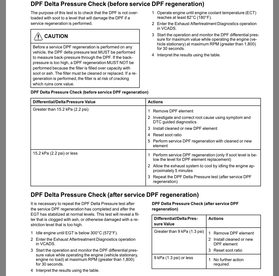

    I have nothing to go by with the numbers from the cleaning. If anyone has there before and after vacuum and soot numbers, I would be interested to compare

    After forced regeneration does the soot level drops to zero?? If they used FSX cleaning machine big yellow thing I can find you baseline numbers.

    Reading your first post, you measured with manual gauge back pressure at 1.3 psi and filter being 80% clogged = your filter is good. Did you measure before the doc or where you tap in with a gauge???

    You might have dpf outlet temperature sensor that reads incorrectly, Amram had a good point. First post you said you checked dpf differential pressure sensor in which way, what test???

    We verified the diff pressure sensor reading by running a backpressure test.

    The soot level goes to 10% after a forced regen

    As far as temp sensor, you got me thinnking a bit. I went back to check my sheets, but the only sheet I have regarding temps was when we were verifiyng egr stuff. These numbers are with the truck off, had been off for a bit by now:
    Oil Temp:64
    Coolant Temp:63
    Air Temp:55.3
    EGR Temp:51.3
    Engine exhaust gas temp:108.3
    DPF intake temp:131
    DPF outlet temp:72

    There lies your answer. Do a DPF tune up = all 3 temperature sensors and a differential pressure sensor.
