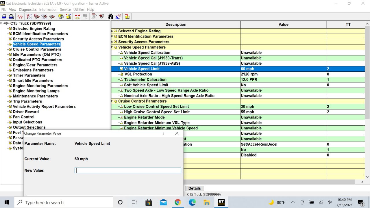

    If you own a truck with a cat, yes you can change your speed and cruise and all that. I took a screen shot of the screen where you change all that and opened up where to just change speed. But as you can see you can change everything. Afew things say unavailable becuase i went into trainer mode instead of hooking up to my truck. ITs late and i have been dinking. to tired to walk out to truck et.jpg

    Thanks for all the help don
