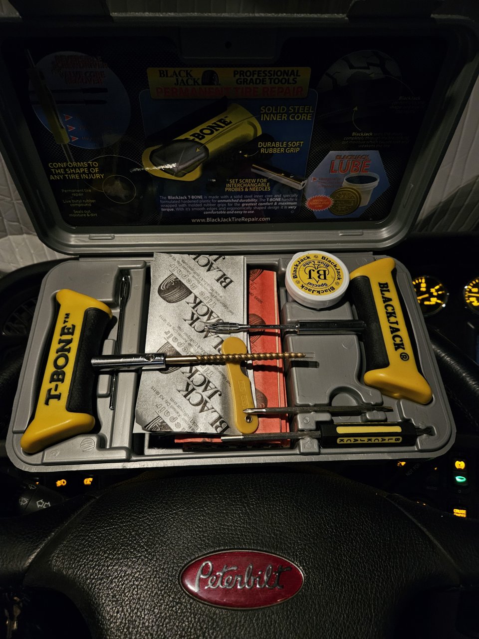

    Never knew something like this existed until reading this thread a couple weeks ago. Came in the mail today, hopefully it never needs to be used...

    I woulda bought the other kit.. comes with a ring you push down on the plug to keep the plug in place while you pull the tool out.

    I love my kit. It’s saved me lots of time and tires.
    ive plugged enough ties with that kit I’m Almost due to get some more plugs. It’s never been an Issue. The only plugs I’d have come out were where the hole was too big. That was a two plug job and it held for another 10k miles before I turned the truck in.
