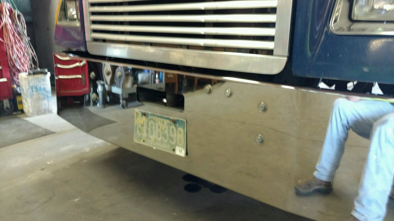

    I just got done with it earlier this morning. I've been off all week. So it's still inside lmao. I don't wanna take it outside but I got to. I'll throw pics up tomorrow but here's the bumper anyway 29552.jpeg

    Very nice ! My classic is about the same color as yours but it's 3 tone blue .
    Its not perfect by any means but has sheen and depth to it now ..I really can't believe it's coming out this good lol
