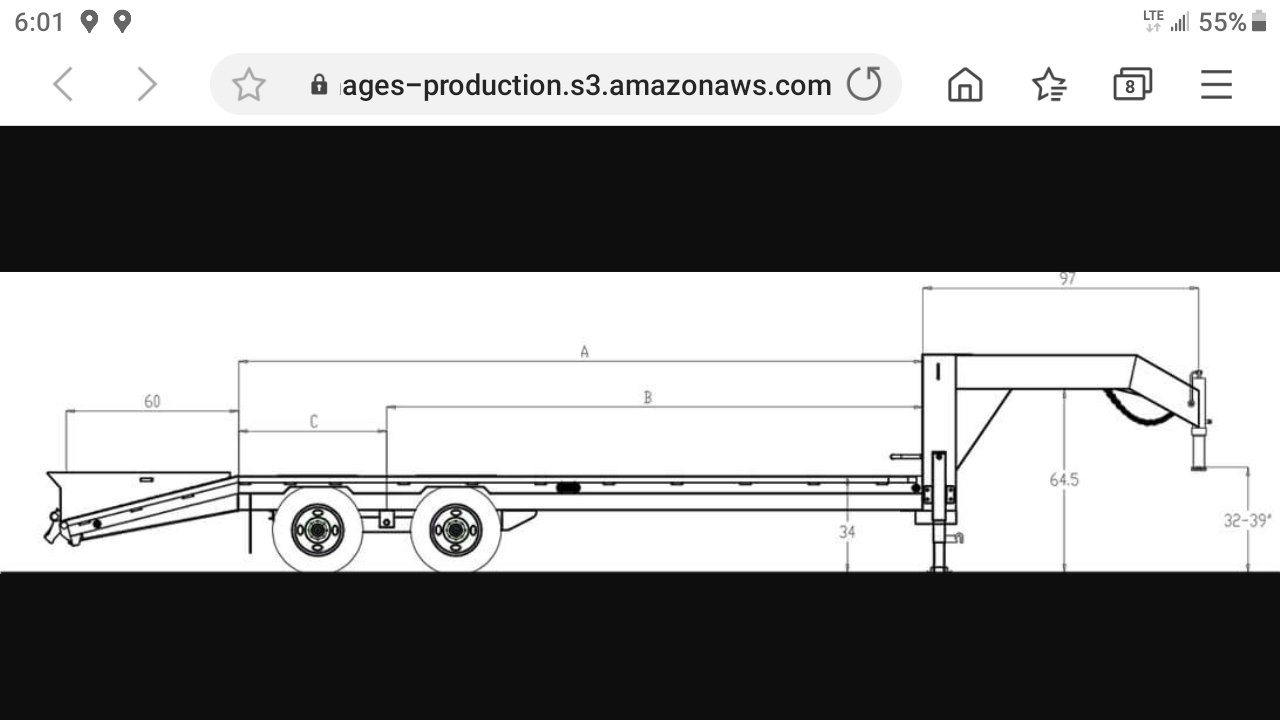

    The F-max seems like a way better built trailer, with that deck camber, in house engineered beams, & new neck design. However they're shooting themselves in the foot with 108" neck. It's just too long to legally work with today's crew cab long box pickups for 40' deck length & meet the '65 foot rules some states require..
    I agree with crocky. I'd want 40' of deck. In the end, it's choice only you can make. You're giving up payload for a heavy spec trailer. In turn it's causing you to consider giving up deck length to get that payload back, cause you don't want 7k axles. 8k axles are really the best choice for under CDL hotshot. I digress..
    So if these were my only options, I'd have to go with the 22gn. I'd expect a deep discount being that it's used. Like $7-$8k off sticker, especially with the current state of our country.. Also is there really anyway to verify the said 50k miles on the wagon.? I doubt that.. Check the build date, can easily be a year old with 100-120k miles depending how hard the previous owner ran..
    Now the big tex will put you over, but only by inches. Never seen anyone ticketed for inches. All the DOT enforcement I've personally asked said they start handing out citations at a foot over length..
    Now I'm making some assumptions about you truck, so correct it if not accurate..
    Going to assume crewcab, longbox, factory front bumper..
    Big Tex, 40' deck, 8'1" neck= 577"
    2017 f350 crew, longbox wheelbase=176"
    2017 f350 center of front axle to front bumper=36"
    577+176+36=789" or 65' 9"..
    If you can get the goose ball mounted a couple inches ahead of the rear axle you can shave off another 2-4" depending.. Either way, if the trailer is priced right, 9" or less is a gamble I'm willing to take..

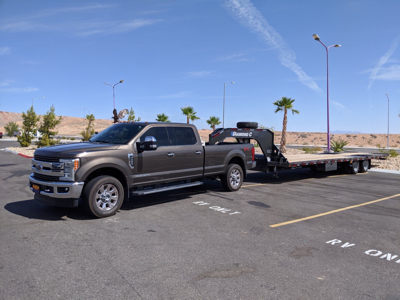

    Wow thank you for all this detail! I only have a few minutes to respond right now but don't want to wait too long and not reply for days. So... I've been crunching numbers with gvw, and length, and looking at what's actually available within 1500 miles. I looked at pj, big Tex, Lamar, Texas pride, and diamond c. Out of all of them, all were new, plus a used big Tex. I was least impressed with big Tex and Texas pride. Welds on the neck were inconsistent and on the rub rail the big Tex and PJ both had pitted dry welds, on new trailers! When I got to diamond c, I was blown away. It was like rembrandt compared to my 3 year olds 'drawings'. I was super impressed.
    The 40' pj, big Tex, and Lamar I saw all had standard necks which put me over 65' overall. So those are out. I couldnt let myself buy something that potentially gives me a fine every time I pull into the scales from the get go.
    Couldn't find a straight deck diamond c 40' anywhere, not within 2000 miles. They're 6 months out on orders :/
    I was able to find one 35', without the max ramps which I don't want. This one had the 12' hydraulic dovetail, and weighed in only 300lb more than the same with the max ramps. Curb weight: 7780, over 1k less than the other 40's I looked at.
    Ultimately, I made a turn-around trip to Utah today, 13:25 hrs, 798 miles and got the hydro dovetail.
    Is it my first pick? No. Was it the best of the options available? I thought so and hope I can make it work. I plan to run it the next 3-6 months, possibly lots of local, and see how it fairs. I know that after 6 months I'll want to swap my truck for something different anyway, so that trailer should hold it's value hopefully until then and I can reassess.
    The big Tex put me at 67' 5 inches, stock bumper to rear of trailer. Don't know why it was more than the 9" from spec sheets.
    In the end, I'm excited but now anxious due to basically having purchased against everyone's more experienced suggestions... A bit embarrassing actually to write this! Anyway, it felt like the right decision after search these last 2 weeks, here's to the start of my trial with this set up..
