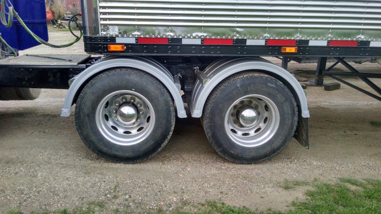

    Hey, I know this is an old thread but I found it useful when I was figuring out fenders for my equipment so I thought I'd throw in my $.02. I ordered some fleet-products poly fenders from fleetpride. The difference for me was price. The fenders where similar to minimizer but the mount hardware was a whole lot cheaper. I figured I'd have to fab up some of it myself no matter what so why spend extra on some fancy brackets when I'll probably be ad-libbing anyway.
    I found the fleet products to be good products. I probably spent 4 hours all told on the single axle tractor including welding up my own brackets, paint, etc. So not too bad. See the pictures.
