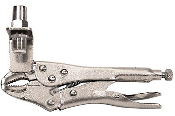

    valor_139_grande.png CbAntennaMountJaws-Qrcs3.gif Here's a couple antenna mounting options
    handlebar and BlackThought Thank this.

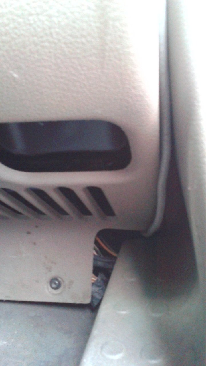

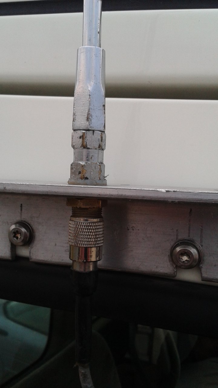

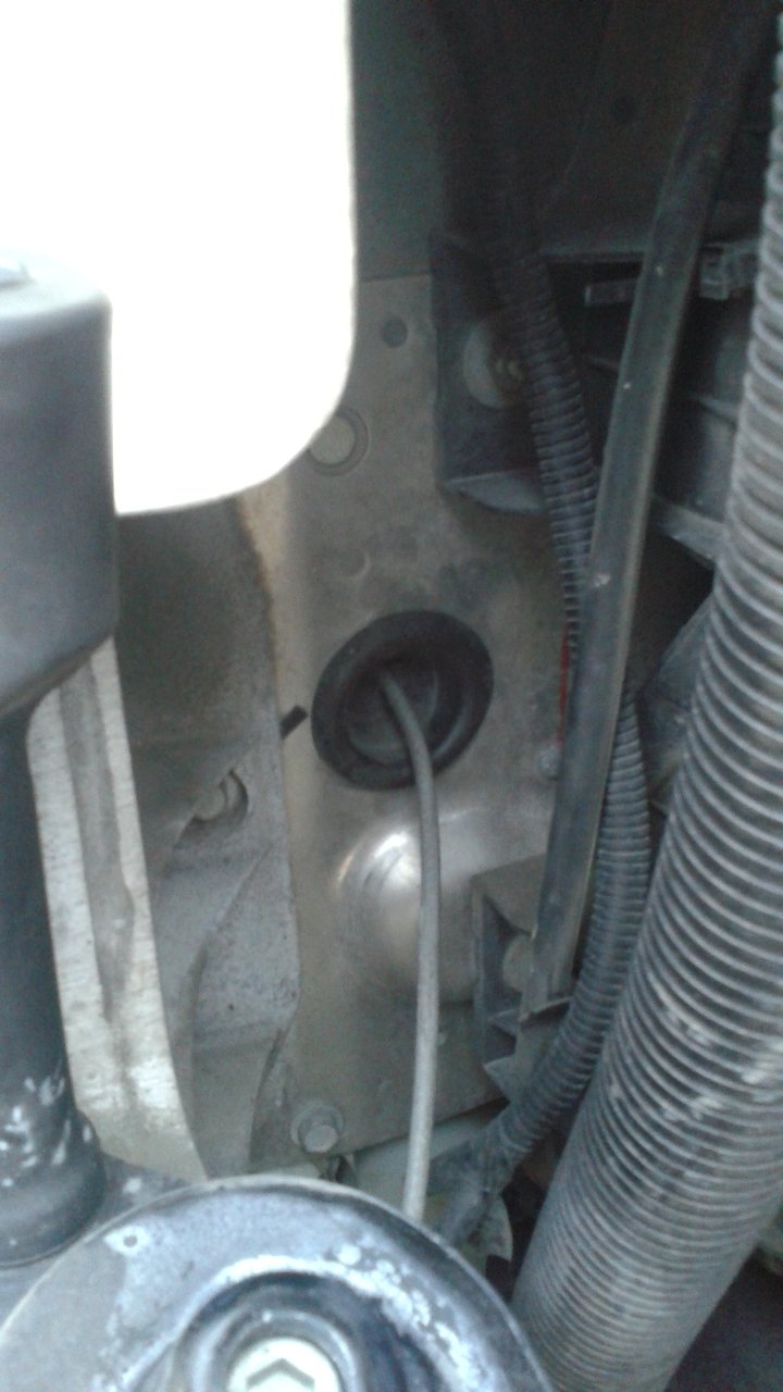

    I have been slip seating for 5 years in a Cascadia and this is my setup. Radio and external speaker are mounted on a piece of plywood. The antenna is mounted on the top of the passenger door with the coax ran into the firewall grommet to the dash where radio is secured with bungee straps. I have found that these trucks have inconsistent ground planes and bonding the door hinges takes care of this. Here are some pics to help explain what I'm talking about.
    BlackThought Thanks this.

    Can I mount the vice grips on the hand bar beside the utility lights? I'm trying to avoid paying 30-50 bucks for something that will only work for the cascadia.
