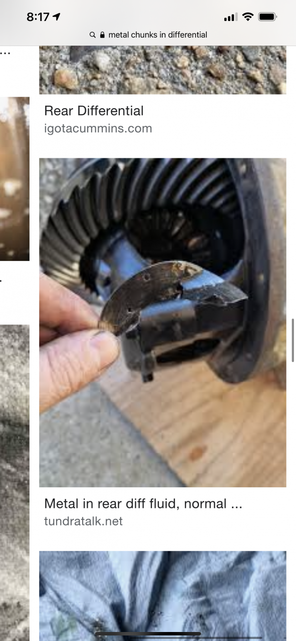

    I need help guys. Idk where to start this time. This vibraion and truck is jumping in the rear end. especially when bobtail. front differential has to much play and rear looks tight very little play. Vibration when accelerating, around 65, clunk when release gas and opposite. when bobtail when try to brake truck also slids like abs i kicking on for some reason. I decided ti lock differentian and drove it around 45 i didnt feel vibration and also if i brake with differential lock and try to brake the truck is braking hard without sliding. What could be this issue? is it possible front diff is bad and both differential are fighting each other cannot synchronize?

    to mention if front diff were found big piece of metal.I’m not talking about shavings this were real pieces

    That pic, is not normal thats for sure. Is the diff. down on the floor? If so, Take it to be rebuilt.
