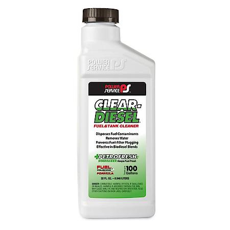

    AED5D53C-7BAC-4616-B9D7-0FDF52140B3E.jpeg White bottles says removes water

    Ah ok thanks, of course the truck stop I'm at doesn't have that one, just the silver and other white bottle.

    Actually, I found a bottle at a tiny truck stop across from the one I'm at. Was $30 for 80oz so it better work..lol
