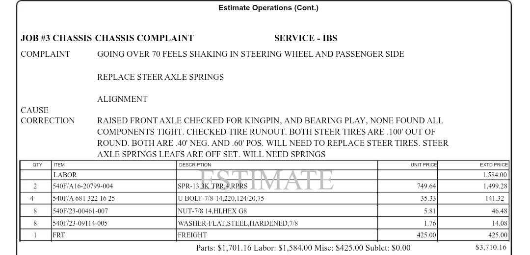

    Practically New tires less than 30,000 miles on them...do the leaf springs have to be replace or is this something a commercial alignment place can fix Screenshot_20240617_212139_Yahoo Mail.jpg

    Does she look like she's sagging on one side?
    Is there a side that's sprung?
    Could be worn bushings in the spring as well.
    I do know that if the springs aren't just right it can add tire wear.

    No way.Would I buy tires Springs new?U bolts which you do need if they change to Springs.Get on down the road don't waste your money there.
