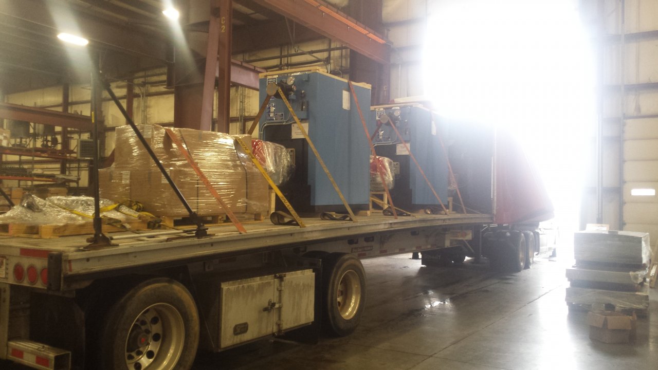

    20170404_091505.jpg Boilers going to Loveland co.
